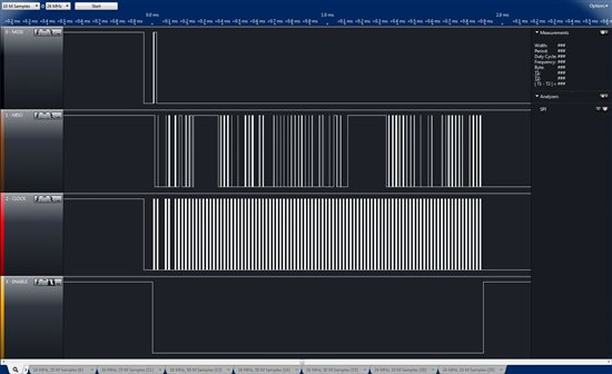

I've already been trying a week to communicate with a SPI Flash Memory (Spansion S25Fl256S )
I'm using a MSP430FR5739 and trying to establish communication but I''ve never got a single byte in return from the Memory.
I've analyzed the communication using a logic analyzer.
Here's what I've got :
For the time being I'm trying with the Read_ID command.
I Enable the chip, send the clock signal and the command (0x90), then keep on sending the clock signal but there's no returned data from the memory...)
I'm really confused because all the timings, voltage and configuration have been double checked and modified in all ways... but I cannot get it to work untill now ...

  • Did you double-check clock and data polarity of SPI flash to match your SPI peripheral settings?
  • Yes, I'm using the Mode 0 with CKPA=0 and the CKPh=0 as well, which is suitable with the device. And the Capture confirms the configuration is correct.

  • Had to read datasheet and it appears that... well... you did not read it carefully.
    REMS (Read_ID or REMS 90h):  The command is initiated by shifting on SI the instruction code “90h” followed by a 24-bit address of 00000h.
    You are sending FFFFFF instead.
    And please read this: "Manufacturer and device Signature (REMS). READ-ID (REMS) is only supported for backward compatibility and should not be used for new software designs. New software designs should instead make use of the RDID command."

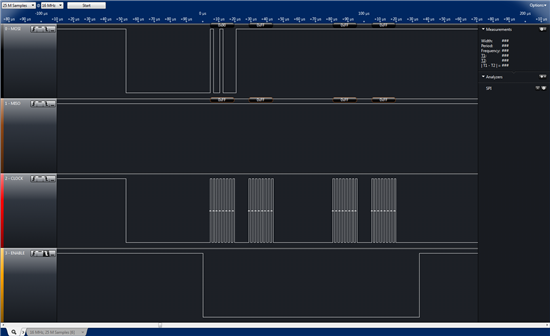

    Also I did see this RDID command which I tried also :
    Here I have the RDID command (0x9F) following by a 24bit 0x000000 address and then the 88bytes of clock pulses...
    I also just added a Pull-up resistor on the CS with no better results...
    What about Power-Up? Are you doing it right? Refer to: 6.3.1 Power-On (Cold) Reset
    Also check about CS timing. Or just try to put few clock periods delay between CS and first clock pulse.
    Currently there is 4.5uS between the CS Low and first clock pulse (so that's like 5 period for my 1MHz clock signal)

  • Hey I got it working !
    I was using the Mode 0 which is CKPA = 0 and CKPH = 0 and therefore I configured
    UCB0CTLW0 |= UCMSB+ UCMST + UCSYNC ;
    As such...
    But looking in detail there was something wrong with the way the data changed respective to the clock pulses ...
    In the end I used
    UCB0CTLW0 |= UCMSB+ UCMST + UCSYNC + UCCKPH;
    And got it to respond ...
    Is it due to a wrong reading on my end or is the datasheet misleading ?
    Thanks for your help !

    Ther eis no generic global SPI standard specification. 'mode 0' is what Motorola calsl 'mode 0'. The TIdocumentation doesn't use these mode numbers anywhere, Instead it calls things as they are: clock polarity idle low or idle high. It is obvious (but inverse to the Motorola notation) that 'CKPL=1' means 'idle high' and 0 means low. Motorola apparently uses 1 for active high and 0 for active low.
    Its always useful to see what bits mean, no matter how they are called and how they are used in different systems.
    So I think it wasn't wrong reading but rather a misinterpretation of what you read based on the wrong assumption of a common notation between different manufacturers. understandeable. And you're not alone - there have been many others fallen into this pit in the past.
