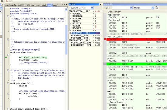

Checking one bit only of IFG2
I am working on a project that uses a UART on USCI_A0 and SPI on USCI_B0.  The UART functioned perfectly before the SPI interface was implemented.  Now it sends on or two bytes out of the UART and then gets stuck in the following line of code:
while (!(IFG2&UCA0TXIFG));            // USCI_A0 TX buffer ready?
because the UCB0TXIFG and UCB0RXIFG are at bits 2 and 3 of the IFG2 and UCA0TXIFG is BIT0 of IFG2 if any of these other bits are high it will get stuck in the line of code above.  Does anyone have any ideas on how to fix this?

    Are you sure about that? "&" is a bit-wise AND operation. First off, UCA0TXIFG = BIT1, not BIT0 (Assuming 2xxx device, since you don't specify).
    So the outcome of the IFG2&UCA0TXIFG portion is either 0x00 (FALSE) or 0x02 (Not FALSE), so the logical NOT operation should invert that.
    You can see the assembly is
    putc:
    bit.b 0x2,&IFG2
    jnc putc
    That looks correct. And the other bits in the register should not affect how this operates. I think you have something else going on. If it hangs, it's because the bit is never getting set.
