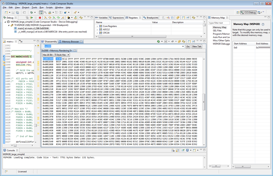

CCS V5.3 software (fully updated), target processor MSP430F5435A, SpyBiWire MSP-FET430UIF(V1.4a with V3 DLL).
The following switch does not enable erase/write access to the BSL memory; thus the CCS tools are UNABLE to update the BSL in FLASH BSL parts.
Properties>Debug>MSP430 Properties> Allow Read/Write/Erase access to BSL memory
Technically you can always read this memory so it is somewhat of a misnoma but does not allow any write acess from load memory or interactively with the memory editor.  The only way of updating the FLASH BSL (especially when the FACTORY fail to load it!) is with third party tools!

    It can read (with the check box set) just cant write (and to prempt the next post the BSL area was already erased - returned 0xffff's).  As a point of information if the memory was unreadable it would return 0x3fff.  As pictures speek louder than words attached is screen dunp showing CCSsrtudio reading the BSL area (loaded BSL via MSPflasher with -b option).  Wnat I need to do is find a way of writing / debugging custom BSL with CCSstudio i.e. how do I get the "enable BSL read/write/erase" check box to work?!

    Well, "protection" doesn't mean "no way back". The protection is done using the SYSBSLC register. As long as this register is writable, the protection can be removed. By JTAG or other code.
    The problem is the SYSCTL register. In it is the SYSPMMPE bit. Once this bit is set, the PMM registers are write protected until BOR. Access to them is restricted to code that executes from within BSL area. However, the boot code usually doesn't set this bit, leaving SYSBSLC open for changes.
    I was denying your statement that 'technically you can always read BSL memory". No not always. However, apparently the debugger clears the protection bit, making the BSL area readable. Which works because neither boot code nor BSL entry-sequence check have activated the config register protection (2nd protection layer).
    Now I don't know what's the problem: If you can read BSL memory (SYSBSLPE bit clear), BSL memory an be erased and programmed like any otehr (except that it isn't part of a mass erase). So I don't know why CCS should have problems writing it.

  • Indeed it would appear to be a problem with the commands that CCSstudio sends to the debugger (MSP-FET430UIF).  I dont have the source for either; it is wholly within TI's gift to look at why their tool with their debugger cannot write to the BSL area of their silicon.  I would suggest someone hooks up a MSP430F5435A part via the MSP-FET430UIF (revision 1.4a), and tries to download the Custom BSL example code to it (techically the latest release of the compiler 4.1.5 doesnt quite optimise it down enough so it is a few bytes too many for the BSL area but I am sure you'll manage)...
