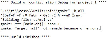

When I try to compile any project, I receive the following message:

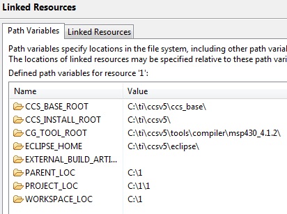

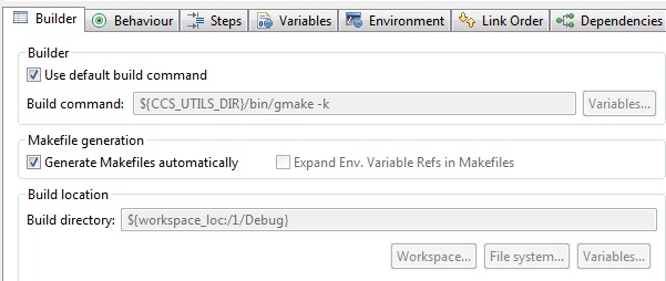

Oleg,
Your build settings seems to be OK.Have you checked compatibility of your CCS version with win 7 x64 OS? If not ,here's link which may help you. http://processors.wiki.ti.com/index.php/Using_CCS_with_Windows_Vista_and_7

Smita, thanks for answer, but my CCS has "5.3 version". It has installed and it has been working properly lately, but something has happened and it not work now.
Result of properly encoding : ‘Ёб⥬Ґ Ґ г¤ Ґвбп ©вЁ гЄ § л© Їгвм. == "The system can not find the path specified"
I've found the solution, but I don't understand how to solve the problem yet.
My username is "oleg" in domain "OLEG-PC". When I've changed the user of OS from "OLEG-PC\oleg" to "SOMETHING\oleg" CCS started to build properly without any errors. I cannot change my domain from "OLEG-PC" to "OLEG", because I haven't login and password for administrator. Сan it make a difference?

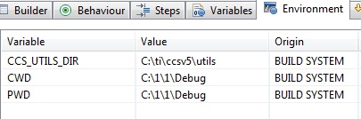

Well, dash and space are invalid characters for the domain name. Underscore isn't :)
But I wonder where CCS uses the domain name.
I rather had expected problems like this with the username (pathnames with spaces or 'illegal' characters are a problem for the underlying toolchains, as they make it difficult to tell pathnames form options)
Maybe the domain name affects your user folder name when you have a domain profile. Or the name of mounted network drives.
