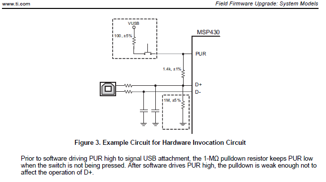

  • Well, the USBPLL_SETCLK_4_0 value needs to change to USBPLL_SETCLK_8_0 to match your 8.0MHz crystal frequency.
    So give that a try first with the C6 example you imported yesterday.
    If you are still having issues, then is it possbile for you to get hold of a board that is being fully powered by VBUS.  Remove the external supply.   The examples in both TI Resource Explorer and MSP430 USB Developers Package were designed to work with devices powered fully by VBUS.
    How to externally power the device is described in SLAA457A.pdf.  What MCU device are you using?  You can also look thru SLAU533b which describes externally powering the MSP430F5529LP's 5V power supply and/or 3.3 LDO.
    Arthi Bhat
  • Hi Arthi,
    I have another board that uses the same device (MSP430F5529) and tried downloading C6 to it. It worked and the device appeared in the 'Ports' section of the Device Manager without my even having to install it! I have looked at the SLAA452 document you referred me to and can only find a reference to how the USB pins should be configured. Comparing my two boards to Fig3 on page 11 of slaa452b (see insert) I see that the one that works uses exactly the
    same circuit as in that figure while the one that doesn't has no 1 MegOhm resistor to earth only a 1.4kOhm to PUR. It says below the figure that the 1 M resistor keeps PUR low prior to PUR going high. Is this resistor really needed? Could it also be connected directly from PUR to ground. Thanks.
  • Hi Halo,
    Great that you got over the INF issue!  In regards to the resistor, I am not sure.  I ususally follow the guidelines and I have not played around with different resistors or connections to see what is possbile.  Maybe someone else might be able to help answer that question.
    Arthi Bhat
