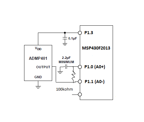

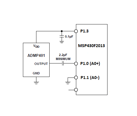

    I used ADMP401 Mems microphone with MSP430F2013 as in the picture below.
    I did get the audio signal, but not very clean.
    Can you suggest a solution ?

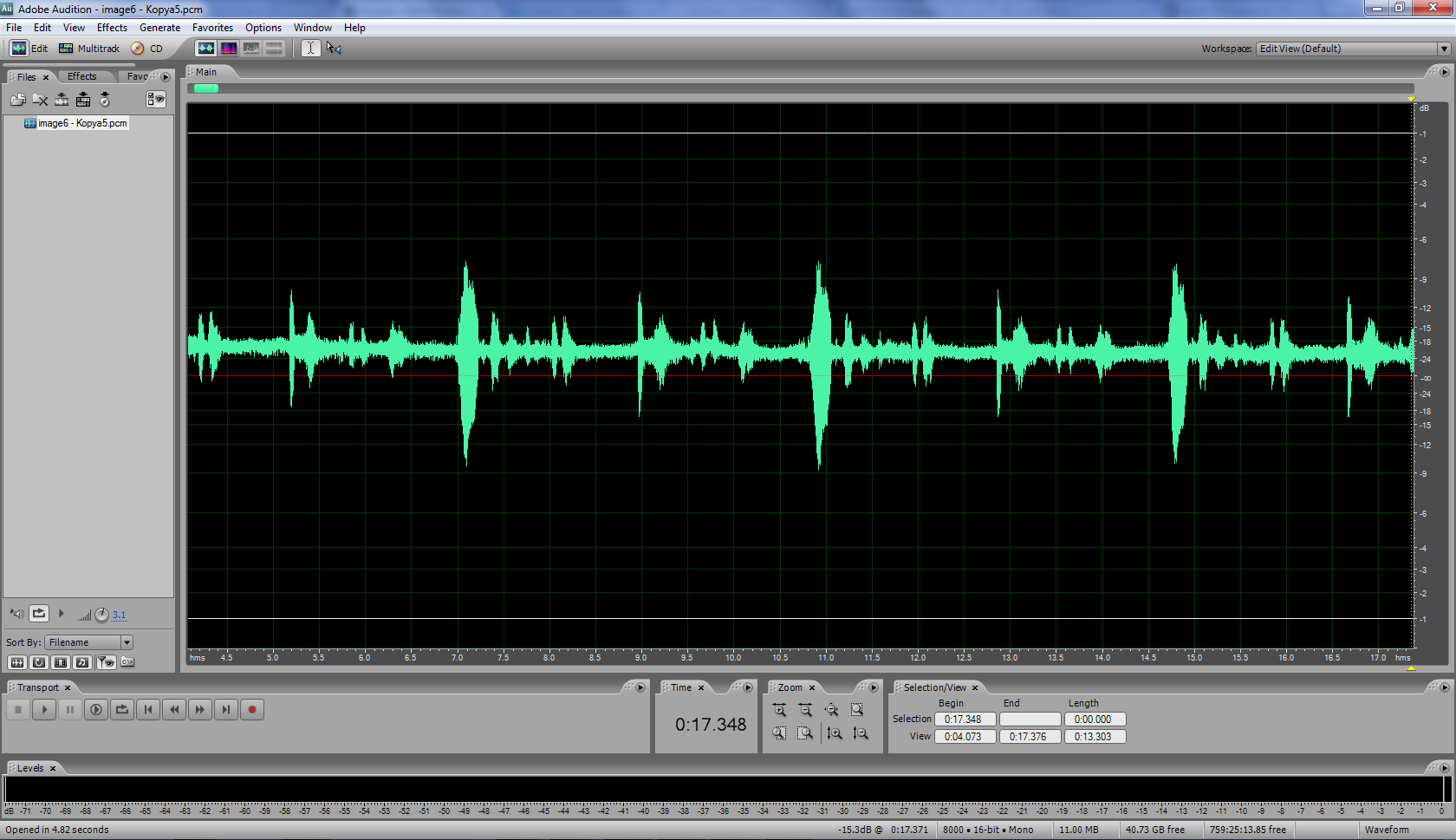

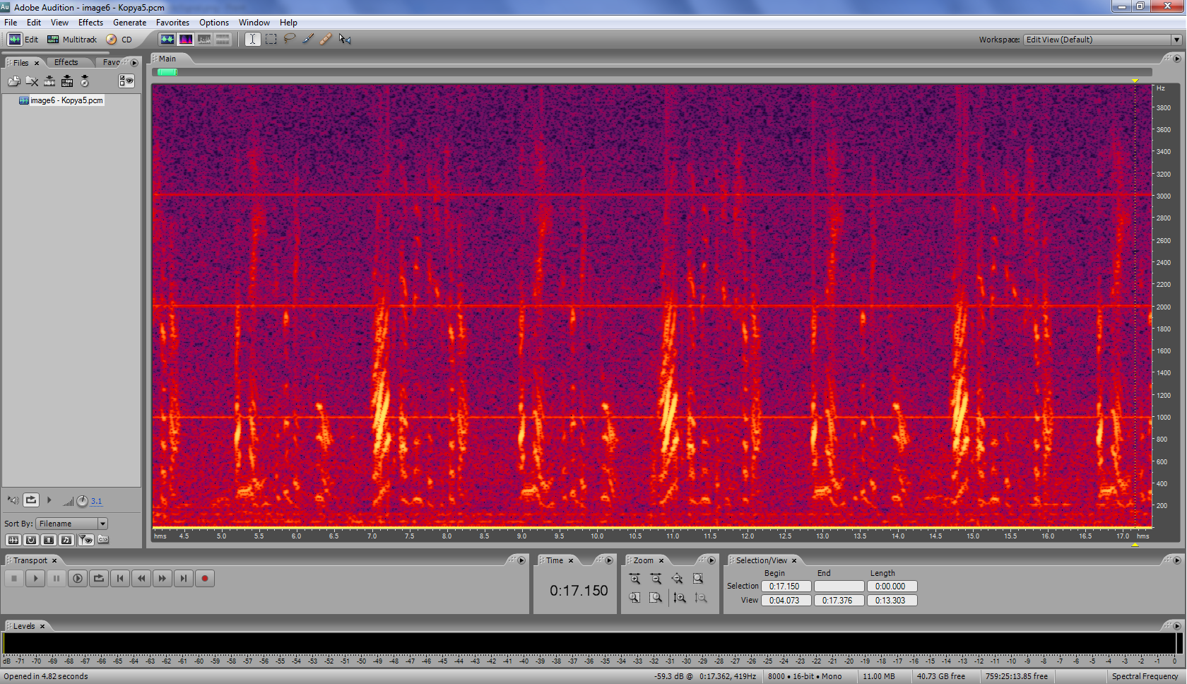

    The output of the audio signal as follows.
    The circuit, as you have drawn it, won't work.
    You'll need a resistor between the positive signal input and GND. 1MOhm or so will be enough. This is to allow the internal OpAmps input BIAS current to flow. If you decouple an OpAmp input by an ideal capacitor, the bias current cannot flow and the input will get a raising offset voltage. With a non-ideal capacitor, the signal will at least be distorted.

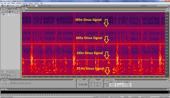

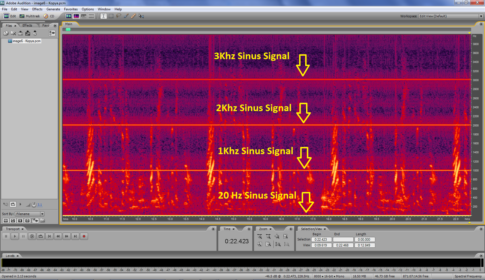

    Ok. I put 1M ohm between the positive signal input and GND. It reduced the noise a little bit , but unexpectedly increased the amplitude of the sinus signal that as illustrated below.
    My Guess (and it's only a guess without more measurement) is that teh previous noise was distortion of the sinus signals because of the offset voltage caused by the biasing.
    Now this distortion noise has been joined back into the original sinus signal.
    If you look closer at your screenshot, you'll see that the remaining noise mostly consolidates in visible small frequency ranges too, which are apparently harmonic overtones of the base sinus signals.
    After all, this looks quite good for a low-cost hardware :)
    But I can not figure out how can i clear this distortion noise has been joined back into the original voice signal.
    When you have a distorted sine signal of, say 1W, then you have 0.9W power on the sine frequency and 0.1W more or less evenly distributed to other frequencies (pink noise). (if it is harmonic distortion due to frequency-dependent feedbacks or resonances, the distribution if of course not evenly and therefore it isn't noise but rather 'ringing' overtones). When you remove the cause of the distortion, the power on the base sine frequency increases the same amount the distortion noise decreases. That's what I meant with 'joined back'.
    On a voice signal, of course distortion causes a power loss too on the plain voice signal. However, since  voice signal is mixed frequency anyway, it isn't clear to see, and the energy resolution of your diagram isn't high enough to see the difference.
