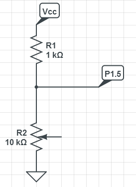

I've been trying to blink onboard LEDs using timerA upmode, but I want to control the TACCR0 value using ADC. I setup the following circuit and connected it to P1.1. What I want to do is to read the value from ADC10MEM and set TACCR0 accordingly.
I debugged the code, ADC10 is working. CCR0 value is set correctly. But whenever I run the code, It starts to blink aperiodically, then after a few seconds blinking turns to normal. However, turning the potentiometer changes nothing, LED just blinks in a constant speed.

  • Now you don't know - it's timer or ADC or both that does not work. So - debug them separately.
    Write test code for timer alone, by compiling with various constants passed to  configure_timer() function.
    When you are sure your timer code is OK - then check ADC.

  • When you reconfigure timer - you reset it. So it's cycle starts from beginning, Right? Now answer to yourself - how often do you update timer CCR register? How fast your ADC is generating new ADC readings? Understood where's problem and why you are getting rapid flashing?

    Take a look at IImars' post, it seems all your problems starts in your timing. I do not know if you have experience in embedded systems, but one of the main problems is the timing. It seems you are launching correctly the timer, but you are triggering an ADC conversion so quickly (while(1)) that the timer does not have time to reach the value before the timer is reconfigured again on ADC ISR.
    About your question
    Gunay Turan said:
    if(ADC10BUSY == 0)                          //This line will stop timer to be configured continuously
    configure_timer(ADC10MEM);
    ADC10BUSY is not the state of ADC operation, is only a mnemonic whose value is 0x0001, that is to say, you are writing a condition like if(0x0001 == 0), it will never be true, for that you never enter in configure_timer function. So with this condition you are not checking the ADC state. If you really want to check the state of this bit, you would have to do something like if((ADC10CTL1 & ADC10BUSY)  == 0)
    About noise in your ADC input, you could modify the ADC input value hundred of  times, but if you do not launch a conversion, any interrupt occurs. And even the input varies during the reading, the ADC only get a one sample in a certain moment.
    On the other hand, it is not required (and according to IImars's post you will have to avoid it) the configuration of TACTL each time you launch it. Simply with this line on the main :TACTL = TASSEL_2  + ID_1;  will be sufficient. For start/stop the timer, you only will do :  TACTL |= MC_1;/ TACTL &= MC_0;

    Maybe that works, but using a delay (and a big delay in particular) or any type of waiting inside of an ISR, you are breaking the basis of embedded programming.
    And as a tip, try to  launch the ADC reading with a higher cadence than the greatest timing possible. If you want to see the LED blinking with a cadence of 100 ms, launch an ADC reading each 1 second, or you will never see the change.
