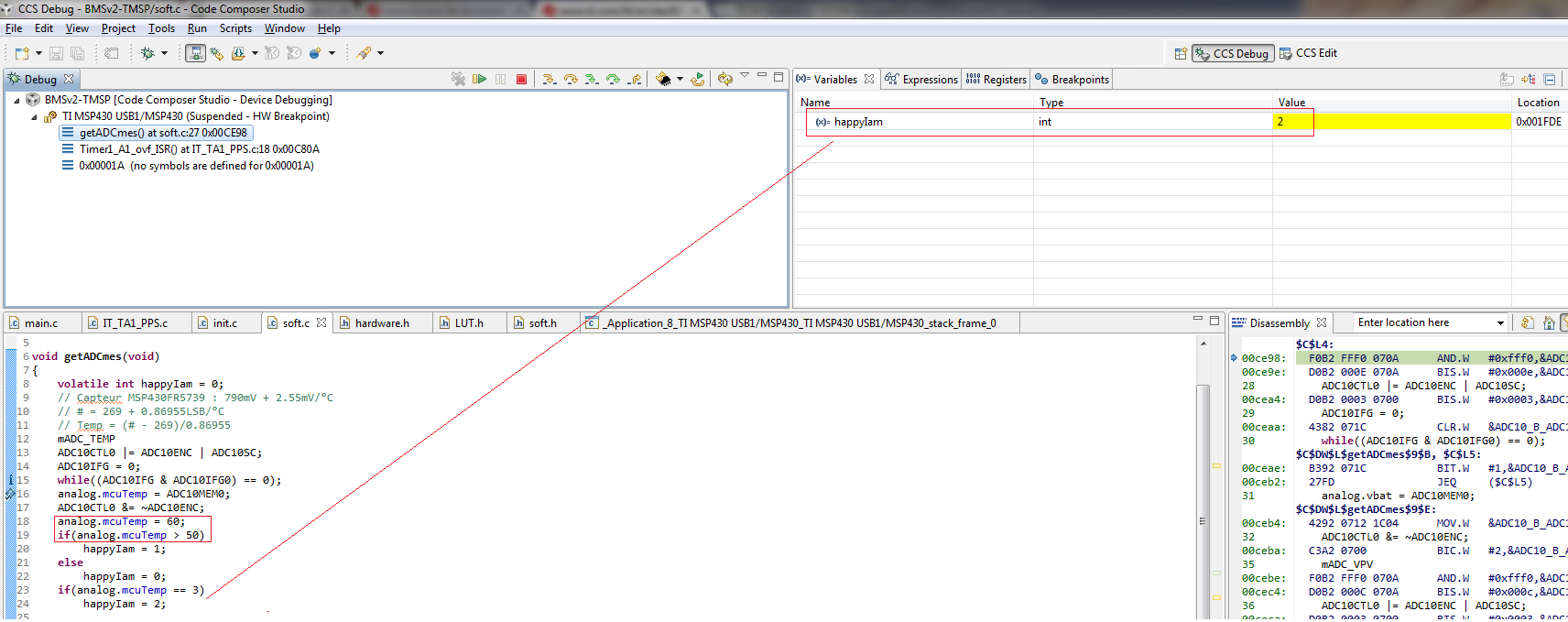

    I am back from holidays and obviously I start to fight with CCS. An old bug is back today. 2 of my colleagues have a similar problem, independently to the CCS version, independently to the MSP430 used. We all use 4-layers EMI-proof boards.
    Typically:
    any_instruction; // foo = random initial value, let's say 60. Debuger say : foo=60
    foo = 42;          // after execution : foo = 42
    any_instruction_on_any_variable_exepted_foo; // after execution : foo = 60 !!! is it a display problem?JTAG?compiler? let's try something :
    if(foo == 60)
       while(1); // will NEVER go there : conclusion = display problem? haha, yes, and no!
    bar = foo;
    if(bar > 50)
     any_instruction; // ALWAYS go there!
    Definitely : TI = bad dev tools...

  • 2 more examples:
    WTF...
  • Had this happen to me many times, very frustrating.  This means that the commercial product, the CCS, sold to customers does not work!  My only choice is to use UART to spit out the values I am trying to check.

    About your problem, itwould be interesting to knwo hat binary code is produced by the compiler. Can't you output the generated assembly code? It is very useful to track down this kind of errors.
    (And often enough, it turned out that it was a coding error all the way, but nobody noticed some implication, while the compiler did)
