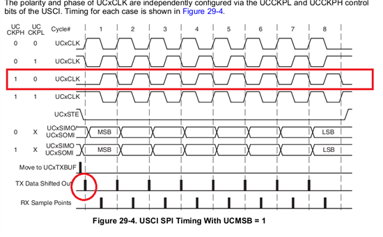

I'm using USCI_A on a  msp430f5419A set into slave mode:  3 pin , clock idle low,  sample on first edge ( ie rising edge ).
At startup everithing works fine. As it's a slave destinated to work in harsh environment I simulated some  spurious clock coming in.
The peripheral looses synchronization accounting for the number of spurious clock received as I expected so I thought to reset the spi at the end of a wrong received frame.
I simply toggled UCSWRST. Now the strange behaviour: the reset doesn't work completly; it always leads the peripheral to a state in which it is out of sync of one clock ie it seems that after the reset it has already a bit in the receive shift register.
So if I inject five spurious clock then at first the peripheral is out of sync of 5 clocks, after reset it's out of sync of one clock.
If I inject three spurious clock then at first the peripheral is out of sync of 3 clocks, after reset it's out of sync of one clock.
Does anyone has any idea why this happens?
Any solution?

  • I have also tried by setting spi 4 wire and usign the CS. As I don't have the external CS I toggled the pullup - pulldown settings in order to assert - deassert it ( but I configured as STE through PxSEL ). I reset the spi while cs is de-asserted but the problem still remain. I toggle a pin on rx interrupt and I see that it is generated on the seventh clock rising edge instead of after the eigth -th.
    As I mentioned the strange aspect is that I keep resetting the communication after each received frame ( 15 bytes ). Everithing is ok. Then I disturb the communication by sending external clock pulses. From this time the mulfunctionality appears ( but the reset is the same after each frame ).
    With the spi set such may, I noticed that if I want to transmit correctly I have to put the tx char on the tx buffer before the cs is asserted. As soon as the cs is asserted the first bit is sent out; the second bit is sent out on the first clock falling edge ... ie the transmission starts before clock pulses ( as reported on manual). Is it possible in some way that also the rx process sometimes starts on the cs assertion so that the byte reception completes on the seventh -th clock pulse?

  • My settings are :
    // Synronous mode, slave mode
    // External clock
    // Clock inactive is low
    // Data  captured on first UCLK edge and changed on the following edge.
    UCA0CTL0 = UCCKPH + UCSYNC + UCMSB + UCMODE_2 ;
    First bit sent out as soon as the cs is asserted ( as  per image ):
    But from the image first rx sample is on first UCLK rising edge. This doesn't work for me: that sample seems to be the second.
