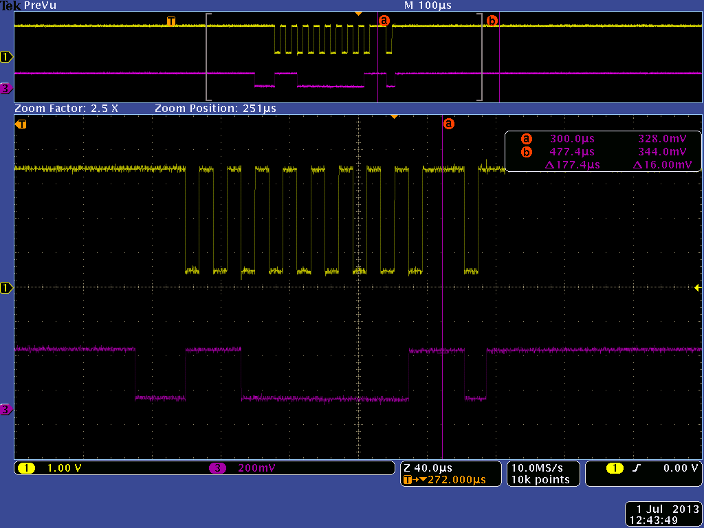

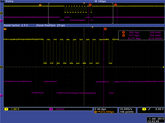

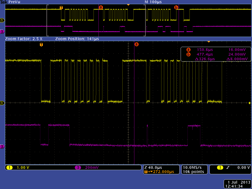

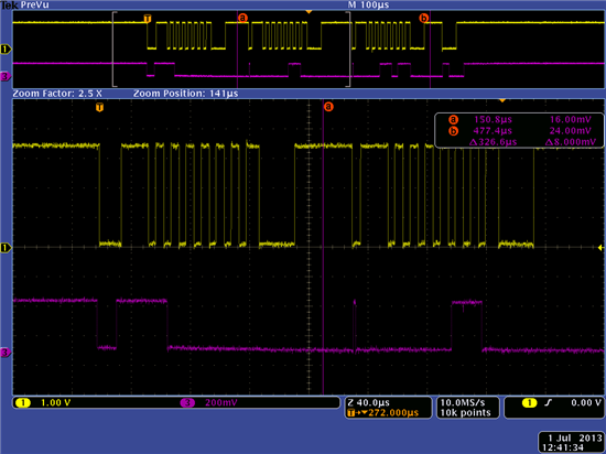

  • Update:
    I am currently trying to just make sure the waveforms for both the GUI (solution) and my MCU are matching. Apparently, they aren't matching enough as you can see below:
    The "a cursor" overlaps with the ninth clock cycle which checks for acknowledge, and in the second case, it stays high, which leads to a STOP condition. Two other noticeable differences are the fact that the START condition for the solution has SCL go low immediately after SDA goes low, as well as the fact that for the solution, the first clock cycle is about twice as long as the other clock cycles and SDA doesn't immediately go high (unlike the second case in which SDA goes high as soon as the first clock cycle starts low). Are these significant problems that are causing my slave device to NACK? I am currently trying to match these two waveforms, and I was provided with two defines:
    #define FORCING_SDA_HIGH() \
    USISRL = 0xFF; \
    USICTL0 |= USIGE; \
    USICTL0 &= ~(USIGE+USIOE); \
    #define FORCING_SDA_LOW() \
    USISRL = 0x00; \
    USICTL0 |= USIGE+USIOE; \
    USICTL0 &= ~USIGE; \
    If someone could help me make two defines for FORCING_SCL_HIGH/LOW, that would be really helpful as I try to match the waveforms as well as possible.
    Matt
  • While the second looks way better, regardign timing, there is a difference in the voltage levels. The first screenshot shows the low voltage as ~0V while the second only reaces ~0.4V. Which might be too high for the slave to be seen as a low transition. Especially if the slave has a rather low supply voltage.
    You should use a weaker pulldown. In theory, the MSP shoudl be able to get the voltage down to 0V, but only if it hasn't to drive much current. (see datasheet for details)
