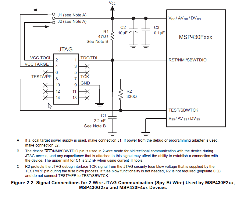

    IIRC this is not exactly true.
    Right, the EZ-FETs cannot blow the fuse. A fues blow is a high-voltage high-current pulse that physically blows a fuse inaide the JTAG logic. (starting with 5x family, this is no longer true, here the fuse is a software fuse located in the BSL FLASH area).
    Teh EZ-FETs are unable to provide voltagte and current for the fuse blow. Also, IIRC, the fuse blow won't work with just the SBW signals of the FET. I remember a specific wiring on the target side required for the fuse blow if the 4-wire JTAG pins are not connected, as the blow voltage comes from TDI signal line but must be applied to SBWTCK/TEST (SLAU320e)
  • The 2 SBW signals alone will not blow a JTAG fuse, this is true.  You need to bring in the TEST/VPP signal as shown below.

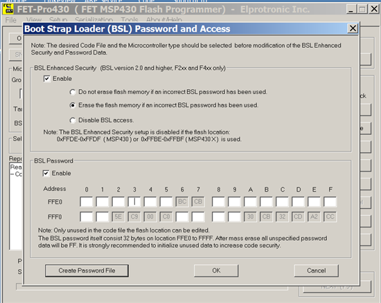

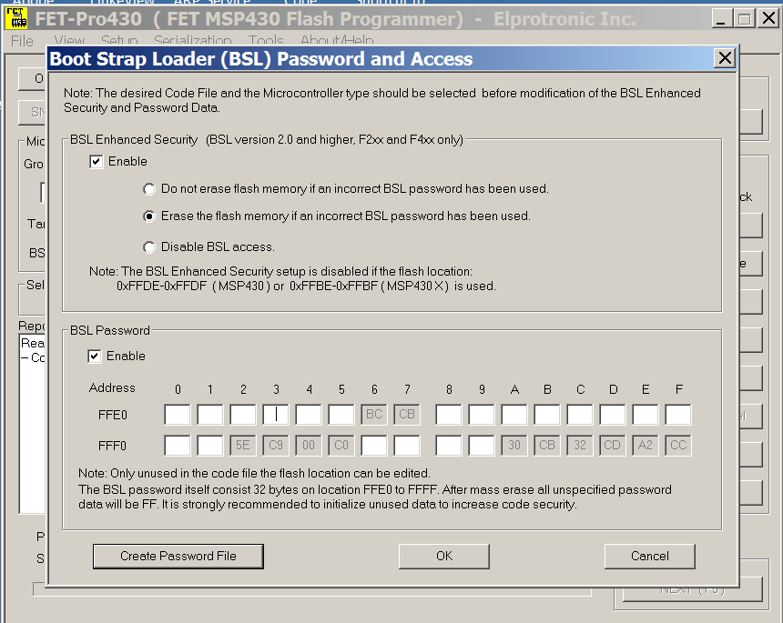

  • Here is a tidbit to be helpful for those that are interested:
    1) The MSP-FET430UIF will blow the security fuse by connection of TEST/Vpp in the JTAG header directly to the port as shown in last post.  Or, use the datasheet specified value on the correct pin of MSP.
    2) The MSP430-GANG does not have a GUI for a user defined password, must use code and be carful not to create a problem by messing up the ISR vectors (the grayed out values seen below).  But, the Lite FETPro430 software does have a GUI, as seen in attached screen shot.  Elprotronic stated that they "may" include this feature in a future software release of MSP-GANG.
