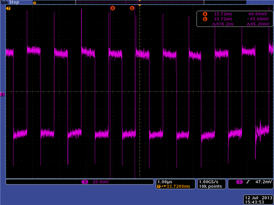

  • Ok, I can do that. If youre still there, I am having trouble reading P1.4 again. I took the code that matters and put it into main:
    int main(void)
    WDTCTL = WDTPW + WDTHOLD; // Stop watchdog
    BCSCTL1 = CALBC1_1MHZ; // Set DCO
    DCOCTL = CALDCO_1MHZ;
    //P1OUT = 0xC0; // P1.6 & P1.7 Pullups, others to 0 // I ALREADY TRIED WITH THESE COMMENTED LINES BACK IN, IT STILL DOESN"T WORK LIKE THIS
    //P1REN |= 0xC0; // P1.6 & P1.7 Pullups
    //P1DIR = 0xFF; // Unused pins as outputs
    //P2OUT = 0;
    //P2DIR = 0xFF;
    P1DIR |= 0x10; // P1.4 outputs // PIN 6
    P1SEL |= 0x10; // P1.4 SMCLK output
    while(1);
    When I probe P1.4 with this code, I get this:
    The frequency is correct at almost 1 us, but It is a very small signal. Am I missing something here? I just added those two lines back in that you told me before (i had it at the correct voltage before, I must have changed something on accident).
    Thanks so much!
    Matt
  • Matt, how did you became TI emplyee? Maybe try KFC? [joke]
    I can't see from here. You have to look at your circuit yourself.
  • Haha, I got it working. Thanks!
