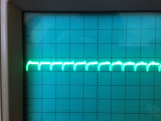

  • Thank you so much for your valuable information.I am actually using the PIn6.6 for DAC0 and connecting the other pin of oscilloscope to AVss of the target board MSP430F6638.I am attaching a image which shows my output on oscilloscope.
    Can you please see this and tell me how to remove the clippping of the signal of small of amplitude 0.07 only.Please do let me know your suggestions for improving the signal.
    Thanks in advance.
    g.
  • With the code you originally posted, you should see a straight flat line. Not more and not less.
    I have no immediate idea how the shown waveform could happen. However, I can construct a case:
    The output is shorted to GND by a standard diode (0.7V forward voltage). After some time the power supply shuts down due to the overcurrent and the MSP is reset. This would explain the clipping and the periodic drops in the signal.
    However, this scenario isn't a very likely one, just one that would give this waveform. Also, the maximum output current of the DAC isn't that much (only a few mA) and I guess the supply would have some headroom too.

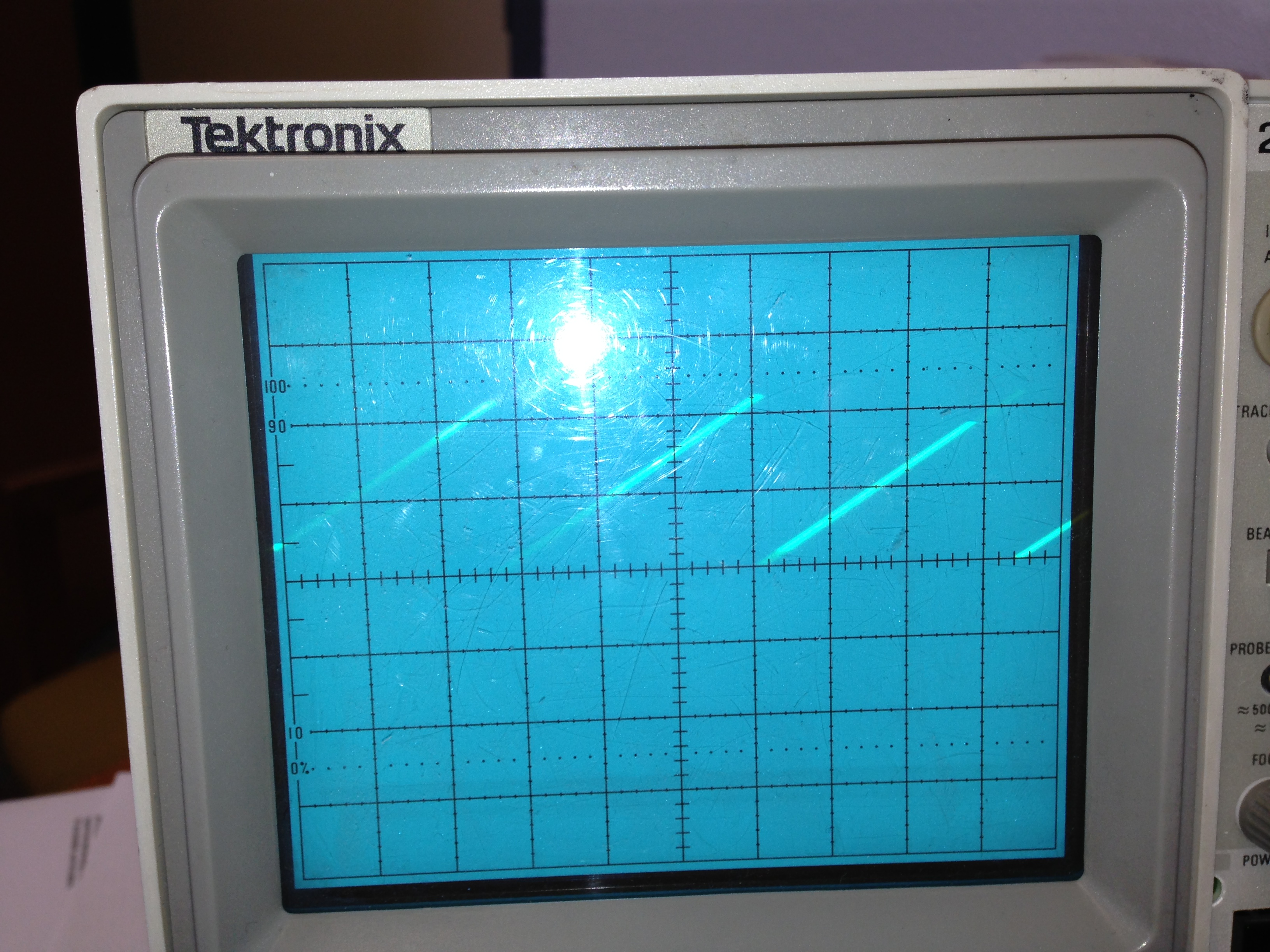

    Please suggest me if I need to do any other modifications.I debugged and ran it.But the output is not in the form of a saw tooth waveform.According to your previous posts I learned that we need to enable the filter.Could you please explain me about this in detail.I am now using the Pin6.0 (3rd pin on the board)and pin7.7(7th pin on the target board).Please do let me know if I need to change any pin connections.I am also attaching an image of my output along with this.
    Please pardon my innocence if I am in lack of knowledge of even basic concepts.
    Thanks in advance.
    g a
  • You don't set DACOPS, so P6.6 (pin 3 of the chip,Are you sure you're probing the right pin?) is the pin on which the output appears. Or should appear.
    However, takign a closer look at your screenshot, it looks like you have a sine wave superimposed, which is a sign of problems with the GND reference.
    And as I said before, the 'pulsed' output seems to indicate that the device undergoes a cyclic reset.

  • Thank you for your suggestions.I got the sawtooth waveform  output which is as follows.
    I am using this code and could you please explain me this code.

    I am also in need of triangular wave.Could you please let me know the logic for that.
    Thank you so much for your patience.
    Please pardon my innocence.
  • The voltage at the output pin corresponds the the last value you wrote to DAC12_0DAT. When you change the value, the output changes accordingly. A value of 0 results in 0V output, a value of 0x0FFF results in reference output (Which is VCC in your case).
    The sawtooth code I outlined increments the value in ADC12_0DAT by 16 in each loop. After 255*16 it overflows to 0*16 (because I is a char and overflows from 255 to 0). Which gives the sawtooth form.
    The speed at which the sawtooth increases depends on the execution speed of the loop and the step size. For a precise timing, you can use a timer, use the timer ISR to update the values and synchronize the output update.
    For generating any waveform, you can create a table of 256 integers which holds the output values. Instead of putting i<<4 into the output register, you can assign table[i].
    You can use Excel to calculate the values required.
    E.g. for a sine wave, create th following document:
    A   | B                 | C
    0   | = A1*2*PI()/256   | = SIN(B1)*4095
    1   | = A2*2*PI()/256   | = SIN(B2)*4095
    255 | = A256*2*PI()/256 | = SIN(B256)*4095
    Column C then contains the values to put into the table. if you copy them to the DAC register, the output will form a fine sine wave. However, teh frequency still depends on the CPU speed.
    With a similar trick, you can create any kind of waveform. I use it in a project to generate a sine wave of up to 50kHz. However, I calculate the values inside the MSP  (and store them in a ram array) based on the requested frequency and amplitude. Then I output the precalculated data using DMA.
