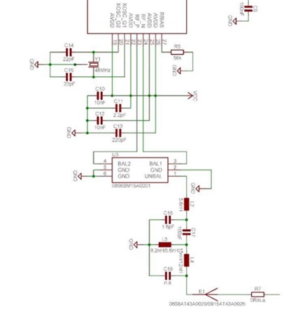

  • Sir,
    I have my own prototype model with cc430f6137 , i designed the layout with balun circuits (868 mhz).
    i procured em430f6137rf900 , in that board, they have designed cc430f6137 without a balun circuits(868 mhs)
    i have a working code for rf transmitting and  receiving , i am not able to transmit or receive.
    does this problem might be of balun circuits?
    regards
  • No BALUN circuit is no problem if you are using a balanced antenna. (BALUN stands for BALanced to UNbalanced). Attaching a standard unbalanced antenna (one side GND, other side signal) without a BALUN won’t work or worst case fry the output drivers.
    However, if everything is made correctly, both methods will emit/receive "compatible" radio waves. So for the receiver it is unimportant whether the sender uses a BALUN or not (and v.v.). Or what type of antenna is used on this or that side. Only frequency and modulation type are important. (and of course sending power and distance)
  • Hello Jens
    Thank you for your valuable explanation. It helps me a lot. Now i am able to transmit my signal from my own prototype board, but i am not able to receive, I also checked the frequency its 890mhz, actually the tuning circuit was for 868mhz, i attach my reference design here for rf section
  • hello
     i can receive my signal in RF_P and RF_n with minimum amplitude .
    suggest me how to tune my circuit for amplitude pk-pk 1v. now i am getting pk-pk around 240mv
  • Well, I’m no RF expert.
    I see you’re using a BALUN chip, so why is there another network between the chip output and the antenna? I’m just asking.
    From my understanding, a pk-pk value of 250mV is quite large for an antenna input, unless there is some sort of amplification. 1V? Wow! Do you connect the sending output directly to your input?
    Or are you talking about output signal voltage swing? Well, it then depends on the selected sending power (voltage on chip output) and, of course, the BALUN fitting the sending frequency (voltage at antenna)
