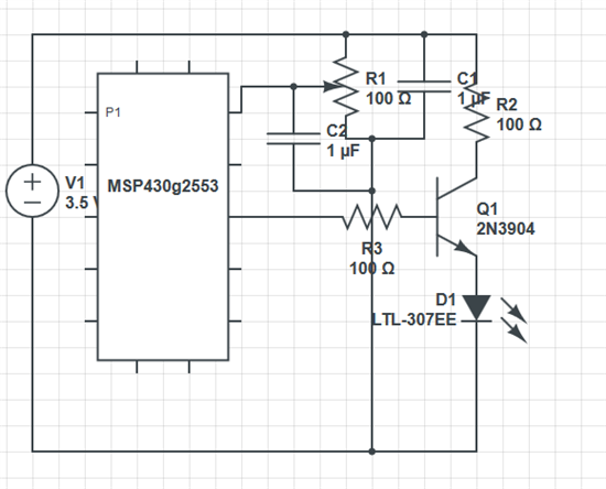

I am using an external temperature probe (MCP9700-E/TO) and msp430g2553

The code is over sampled 12 time per reading and is pretty stable with temperauture increasing/decreasing/remaining constant.  The probe also has decoupling caps on.
The problem comes when I switch an external heating element on/off with the msp430.  This is through a transistor, another transistor then an ssr.
Turning the output off causes the adc to decrease about 10 units, even with the over sampling.  This causes the output to oscillate on/off/on etc and also the temperature readout to fluctuate somewhat wildly.
Am I doing something wrong or is the internal reference going to be that unstable during switching?
    Could you show schematics?
  • Sorry, its on the breadboard only.  I have simplified the circuit with just a transistor and an led on the output (with resistors) and still the same problem.
    This is a rough layout but numbers of components and values are changed (and r1 is the fancy thermistor thing)
  • Is the heater powered by the same power supply as the MSP?
    If so, does the voltage drop when the heater is on?
  • The heater is currently on a different power supply so no voltage drop.
    When using the led the sensor voltage is only unstable briefly after switching.  In either the on or off state the output is consistant
  • R3 value is unnecessarily small. If VCC supply is weak enough, it can be source of your problems. Try R3 increasing to 1k or so. Do not forget about decoupling capacitor(s) between VCC and GND as close to uC as possible.
    100ohms of R1 also is just waste of the power. You can use 10k here.
  • The contact resistant of a Breadboard is quiet high.
    Create a separate Analogue ground on your Breadboard connected separated from digital signals directly to the MCU (solder a second Vss leg to the MCU) and also create here a new AVcc.
  • Yep, a separte analog gnd routing is always a good idea if analog precision is required. Many MSPs have dedicated AVss and AVcc pins for this reason.
    As any current on the GDN traces changes the GND level. And any current change causes GND ripple.
