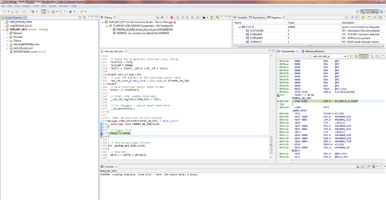

    Problem in debugging can be caused by EEM bugs. For example i remember that i had headache debugging 5xx/6xx devices with LPM, and it turns out it is due to EEM13 bug.

  • James Hillman said:
    Can I assume, that if SYSRIVECT is set, and the code works as expected, then the interrupt handler is indeed running in RAM?
    SYSRIVECT won't put your handler into ram. It will tell the processor to fetch the handler address from the end of ram instead of the end of flash (of course, the address of the program start point is taken from 0xffff in any case, as after a reset, SYSRIVECT is reset too)
    James Hillman said:
    if I put a break point in an interrupt handler it displays a memory location in Flash.
    If you put a breakpoint on an interrupt handler and the system breaks in flash, then the interrupt handler is obviously located and executed in flash. The linker-generated MAP file will tell you the location of all linked resources in your program.

  • The map file shows that the main code (main, init, send/receive) runs in ram (RUN-ADDR=0x1c00). But what about your ISRs? They are not listed in this table.
    Again, if you put a breakpoint onto an ISR and the debuggers breaks in flash, then the breakpoint was put in flash and therefore the the ISR is still running in flash, not ram.
    It is possible, that the attributes required to tell the compiler that a function is an ISR overrides the pragma that tries to locate the ISR in your FLASHCODE segment.
    Usually, the compiler/linker will handle ISR placing by itself, ensuring that ISRs are placed in lower 64k (interrupt vectors are 16 bit only, so they can only point into lower 64k address range).
    If this is the case, then you must manage it by your own: copy the ISRs from flash to ram, copy the vector table form flash to ram, change the vectors to point to the RAM location, then set the bit for using the RAM vectors.

    I am still struggling to get confidence in setting up interrupts to run in RAM. As per the forum post, I have reported that the FET programmer always reports a flash address. I opened your project from http://processors.wiki.ti.com/index.php/File:MSP430F5438A_RAM_INT_VECT_CCS.zip in CCS5 with the latest updates. The code runs but if I place a breakpoint in the ISR it shows an address of 0x5C00 – which is flash. Please help.
  • James,
    i think there is a slight misunderstanding here. The RAM_INT_VECT_CCS example is an example code for moving only the interrupt vector table to RAM. However i believe what you want is to move the ISR to RAM. In this case, i would refer to code example for MSP430F54xx(non-A) version: http://www.ti.com/litv/zip/slac166s.
    Have you tried this?
  • Hi Leo,
    Thanks for the fast reply - that was a massive misunderstanding on my part. I will test this later today - but I have many applications now which use functions based in RAM - I didn't release I could use the same approach for ISR as well.
    Are there any limitations to what code can be ran in RAM? I tried to move a function from C, and all the functions which it depends upon to RAM also, and it crashed the MSP430. The routine included DMA and LPM. Maybe, I will investigate this further.
    Thanks again, James.
