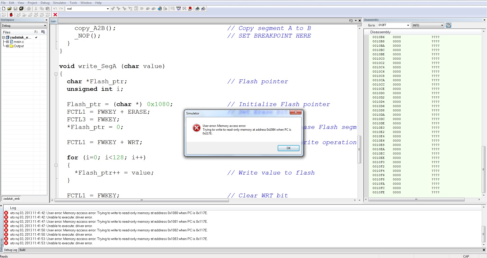

    And while Download and Debug this error occurrences
    How to solve this?
    Regards.
  • Sorry but I do not know IAR very well. You should check segments in linker script.
    This might be useful: http://supp.iar.com/Support/?note=55224
    Maciej

    If you write the data only once, after the device ha sbeen mass-erased, you can simply block interrupts, set the flash controlelr to write mode, then assign the data to the struct, the disable the flash controlelr and re-enable interrupts.
    If oyu want to dynamically change par tof the struct later, things are a littel bit more compilcated, as you need ot make a backup of the original data (e.g. copy the struct member by member into a second struct that was created locally), make the change int eh backup, erase the info memory, then copy the struct back.
