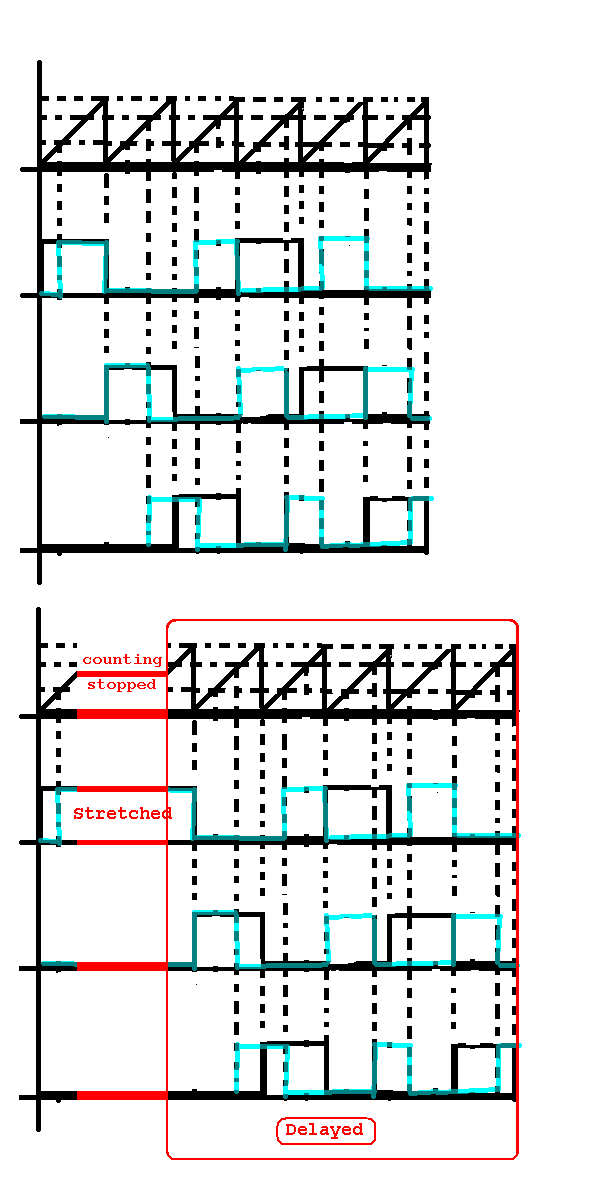

    I'm using msp430g2533 and would like to make a program that generates 3 ​​PWM signals to control a three-phase motor. I want to change both the Duty Cycle him as the lag.
    I thought about it for use Timer_a microcontroller controlling each cycle count, each stopped the timer count is made​​, and a reading test to see if the count changes state.
    Will use 3 ports output timer. I attached a picture (excuse the drawing badly done) to show a little of what the project would be.
    In the drawing just being varied the duty cycle, which makes the program a little bit, however also want to vary the gap. The signal in black is with duty at 100% and the signal in blue is with variation in duty cycle.
    I doubt if told to stop counting another cycle or 2 of the timer, which will cause errors in the program if I do not prevent me.

  • Macio,
    Sorry, I do not quite understand what you are trying to do. The waveform in your drawing can be generated by MSP430G2533 under some restrictions.
    (1) The minimum spacing between all the vertical dash lines must be big enough to provide time for the CPU to set them up.
    (2) You must have some way to supply the CPU with the desired position of the next vertical dash line.
    I also do not understand why do you want to stop the Timer from counting. Doing so will stretch the pulse that is currently active. It will also delay all the pulse downstream.
