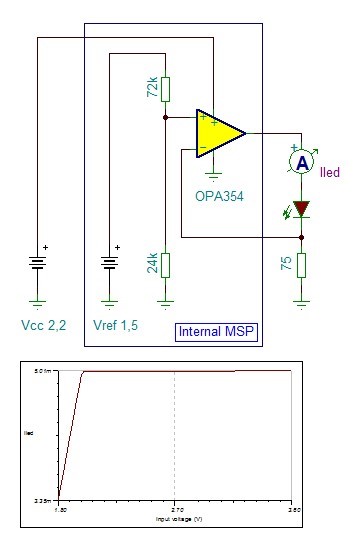

  • If you do like the internal Op-Amps (which I do also) and the current does not exceed 5mA, you can also consider this setup;

    thanks also for the op amp solution. I'll have to find a MSP430 that has one.

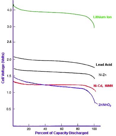

    LOL :D Of course batteries discharge. Main question is: how fast you discharge them, when (at which voltage) you treat them as discharged. If you look at discharge graph, alkaline have "more or less constant" voltage down to 80% discharge. NiMh rechargeable have even better discharge results.
    Low power PIR sensor can operate for months from two AA batteries. Instead of trying to implement constant current LED driver using __built__in__ opamps to squeeze out last 10% of battery charge I would rather implement "low battery" indicator. In case I really need constant current drive of 0..20mA LED then I would go either 1) three AA alkaline/nimh batteries and 3V linear regulator 2) boost 3V switching regulator.
