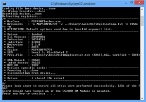

  3. Flashed MSP430 with download_cc3000_fram_Basic_WiFi_App from installer in swrc275a.zip
    Result LED5 (Note that the confirmation states that LED1 should be lit)

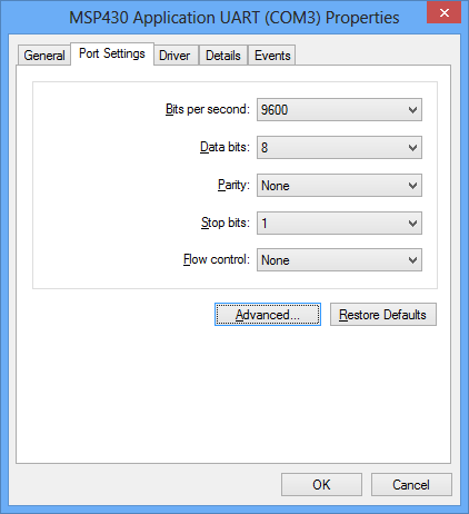

  4. Configure Port Settings (Windows)
  5. Configure Putty Settings
    (Note I did change the Local Echo settings and matched the serial settings with Windows config)
  6. Open the COM connection (click Open on the Putty screen)

I have played around with the Baud rate changing from 9600 to 115200. I am hopeful that the MSP430 is on the correct COM port because I am able to get the "putty terminal" If I use the incorrect COM port it notifies me that it is unable to open a connection.
I have uninstalled/reinstalled the MSP430 drivers with no difference.
