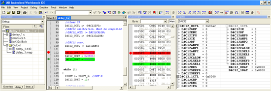

For MSP430F1612, for DAC12 I cannot enter the value in DAC12_0DAT. Below is the code and also the screenshot of IAR. As you see, no data loaded in DAC12_0DAT, neither voltage on P6.6/DAC0 processor pin.
Any idea for fixing this?

  • I don't know why teh registers don't show a value, but it is likely just a screen update bug.
    however, your code has some flaws.
    You set DAC12IR, bu twith the next isntruciton, you implicitely clear it again. Also, while DAC12LSEL is 0, DAC12ENC is a doN't care - you don't need to set it nor does it serve any purpose.
    Also, all the bit clearing is superfluous. The default value is 0 anyway, and wiht the first "=" assignment, you clear all bits anyway which aren't set in the assignment.

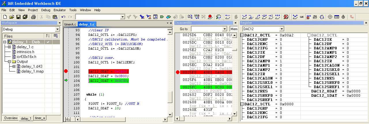

    The registers are not updated as it should be either as I bug I did at one or several points, I guess, or it is a bug in IAR IDE. How can you explain that other resisters are updated correctly, and only DAC12_0DAT is not updated correctly? The images blow are the proof.
    We are all learning from every mistake/bug. If you want, I can send you more screenshots.
    According to TI MSP430 User Man, DAC12IR should set Input Range. Following this instruction, I set In Amp Gain, which should not be conflictual with input range; it should affect the slow rate only,  which is another story.
    I agree that some instructions are redundant in effect. I put them them just hoping that it will work, which is not the case. Definitely, the bug is hidden somewhere. For sure I keep working on this until I'll find the bug and also I will post the result for helping others.
    Below you have some screenshots with notes. If you have other suggestions, please tell me.
    The bits are independent, yes, but you raccess of the register isn't.
    DAC12_0CTL |= DAC12IR;
    DAC12_0CTL = DAC12AMP0 + DAC12AMP2;
    The second instruction writes DAC12AMP0 and DAC12AMP2 bits to the register and clears all others, including DAC12IR. You simply omitted the "|" in the assignment.
    I never had any problem swith the DAC on the 1611. In fact I'm using it heavily.So I guess it is a display problem in the debugger. Can you try a manual refresh of the register view?  Since fetching data through JTAG is very slow, the debugger doesn't update everythign at every step. I agree that it shoudl do so here, but I don' tknow th ealgorithm with which it determines whether to update or not.

  • Thanks Jens-Michael,
    Your hint worked for me.
    I had also another bug in my code:
    volatile unsigned short DAC12_0DAT;
    not used, which prevented to see DAC12_0DAT updated. I removed the declaration and now is OK.
