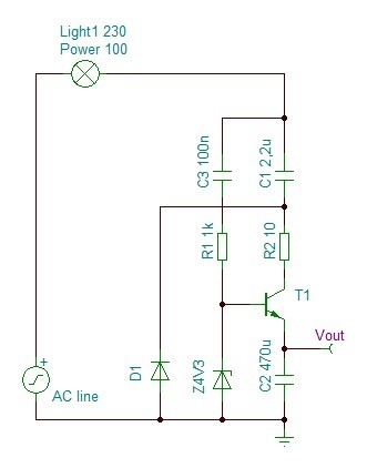

I have the task to build smart light switch. Is there any reference design for powering up the MSP430 board from power line like on the picture below? The key problem is there is no zero power line, just the ligt switch breaking the hot power line going to light bulb. Of course, then light is off, it is very easy to get power by consuming small current thru the bulb. But this controller also should work then light is on.

  • You can try something like this;

  • Please explain, is this design will make lamp to light? Which is duty cycle? Which is power dissipation here? Which transistor is used? Will this work on lamps from 10W to 200W? How to switch off the lamp, continuing to power the scheme?
    Thank you!
  • The original question is How to power-up the MSP430. This is an answer, but for the power source only. Al other you have to calculate/add yourself.
    To light-up the lamp you have to add a Triac or SCR.
    The Duty-cycle is defined by your software in the MSP.
    The Power-dissipation you have to measure or calculate and depends on the 3.3V load (MSP etc).
    The transistor can be small 1A, Vce >= 300V, also the capacitors should be >= 300VAC.
    Certainly with 200W, the minimum depends on the Triac (minimal AK current).
    Automatically every 10mS (at 50Hz).
  • So, it is not what I need. I need to power up my device when the lamp is ON.
  • If you add a delay of 1mS prior to fire the Triac every 10mS you get after 250mS enough power to Power-Up your MSP (3.4V @ 1mA). If you need less power you can short the 1mS. In the main time your lamp is On.
