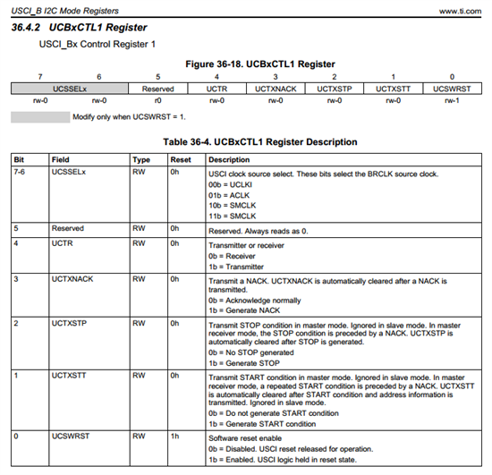

We are using the driverlib\MSP430F5xx_6xx functions included in the MSP430ware_1_60_01_11 version. By comparing the functions  “USCI_B_I2C_masterSingleReceiveStartWithTimeout” and  “USCI_B_I2C_masterSingleReceiveStart” we have detected a potential bug in the function “USCI_B_I2C_masterSingleReceiveStartWithTimeout".
bool USCI_B_I2C_masterSingleReceiveStartWithTimeout(...)
        //Poll for Start bit to complete
        while ((!(HWREG8(baseAddress + OFS_UCBxIFG) & UCTXSTT)) && --timeout) ;
void USCI_B_I2C_masterSingleReceiveStart(...)
        while (HWREG8(baseAddress + OFS_UCBxCTL1) & UCTXSTT) ;
Replacing OFS_UCBxIFG by OFS_UCBxCTL1, it  works fine.
Raul.
From MSP430x5xx and MSP430x6xx Family: User's Guide revM page 972:
