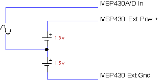

  • Back to the original question using no external components --- Would this work if USB was not connected? And if so, would it work with the USB connected for debugging if the USB + power was cut?
  • Yes. - If you use VCC as reference for ADC and don't use two batteries but proper voltage divider (like two resistors and optionally buffer opamp).

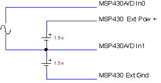

    In case of batteries, which will have different discharge curves, you have to measure middle point using ADC - to know where your AC zero potential reference actually is.
  • Well, when AC is floating;
  • IImars:
       If I understand you correctly, then by measuring the drift of center connection of the two batteries then no external resistors would be needed.
    Yes. Actually resistor center connection also shall be calibrated at least once, battery center connection you shall recalibrate more often, but not necessarily every AC measurement.
    You shall also consider that 3V reference to measure 1Vpp signal means losing 2/3 of ADC range, not to mention that supply voltage is not that clean reference.

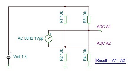

  • Prasad Aritakula said:
    Can you please suggest a simple circuit for level shifting AC signal with minimal components.
    Asuming you have a launchpad and ground referenced 1VAC signal, I would just use two 10 k resistors.
    Connect the first resistor from 1 VAC source to any ADC pin on the launchpad. From this ADC pin connect second resistor to the VCC (+ supply).
    This setup will level shift the input to 50% of supply (and attenuate the signal by 50%).
    Use long ADC sampling time to compensate for the source resistor .
    Your ADC should use the power supply as the voltage reference.
    This setup should give you a value of about 512 for a 0 input voltage.
    Good luck.
    Peter
