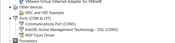

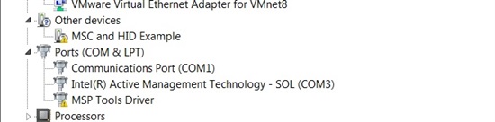

1. When plugged in
and the device manager shows

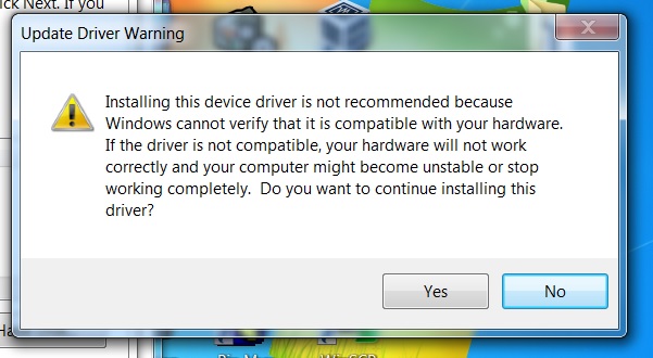

3. When attempting to load drivers from my machine
After I press "Yes" I have a BSoD and my PC reboots.

    When plugged into USB I have "MSP Tools Driver"
