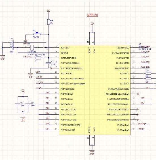

I'm working on a project with an MSP430g2955. I have a 32.768 KHz crystal with 12pF capacitors.
I need to generate a 1sec timer and I've chose to use the Timer B.
The problem is that with the timer B enabled, the sistem restart after 1-2 minutes. The hardware reset on the pin 7 is always up, so I don't think that this is the problem.
This is my code for the clock:

Do you see any problem in everything I posted?

  • Hi Nicola,
    I don't see any reason your application should reset after 1-2 minutes.  Can you post more code from main?
    FYI, your application may not be interrupt safe.  You should synchronize access to all three fields in the <timerset> data structure when you write them to the LCD.  If a timer interrupt happens after you read the <sec> field but before you read the <min> field, your displayed time could be wrong (temporarily).
    Typically the solution is to mask interrupts, make a local copy of the three fields, and then unmask interrupts before your call to sprintf().
    Jeff

  • I still don't see anything wrong.  It is difficult to help only seeing small code fragments.
    I notice you have enabled the interrupt for an oscillator fault.  Do you have an interrupt handler for it?  If not that could be causing the unexpected reset.
    Maybe you could post more code.  I am intrigued by the "case 13:" I saw, because it is strange.  I'm also concerned that if one piece of your code is not interrupt safe then other pieces might also not be safe.
    Jeff
