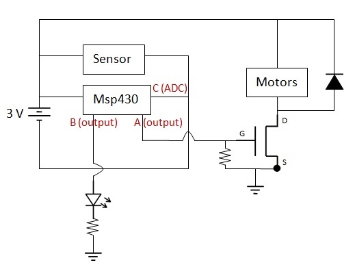

Hi all,
I have been using an old LaunchPAD (pre-December 2011) with an msp430g2553. I was seeing some issues with an output pin (P1.2 – controls a motor circuit) not being set to VCC (3V). This problem was occurring intermittently and each time it did occur the pin was set to 2.4V instead of 3V. See pin A in circuit below (note that there are linear regulators for the sensor and msp that drop the voltage to 3V). I thought that there was something wrong with the LaunchPAD so I changed it out yesterday. Now I’m seeing a similar problem on a different pin (P1.6 – turns on an LED). See pin B in circuit below. The output should be 3V but it’s consistently set to 1.7V. Whenever the LED is triggered to turn on (output at 1.7V), another LED, that’s connected to the power supply, dims. (See table below for a summary)
Another issue is that the value at the ADC pin (P1.1) is different between the different LaunchPADs (pre and post 2011). This makes no sense to me. I have a resistive sensor that the ADC is measuring the voltage of and I tested under identical conditions.
I’ve tested both LaunchPADs with different msp430 chips and there is no difference between chips, only between LaunchPADs.

Are there any fundamental differences between pre and post-2011 LaunchPAD? Any ideas on what can cause an output pin to not be set to VCC? Any ideas on what can cause the ADC value to change between LaunchPADs?
