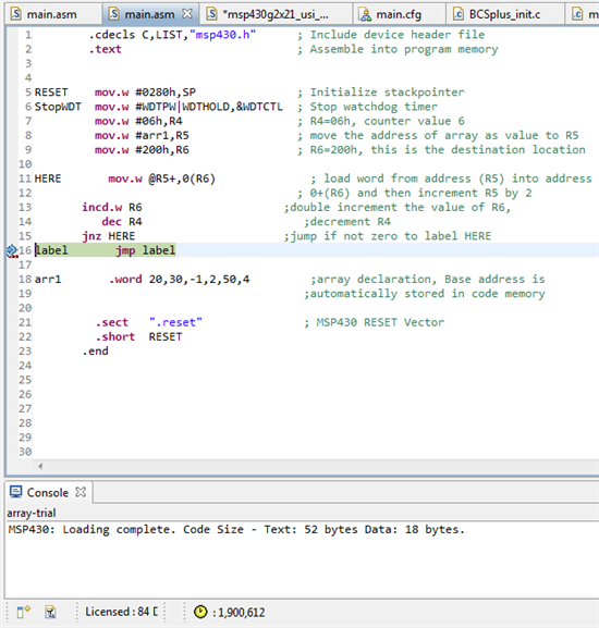

I am working with assembly codes using Code Composer Studio v5.5.0 for MSP430. When I enable the clock I get the CPU cycles as 1,900,612. It means that it should take around 1.9 seconds to execute( MSP Frequency is 1Mhz), but when I compared it with my watch it took around 6 seconds. Can anyone please tell me if the relation of CPU cycles and CPU seconds? Is it cycles/frequency or is there any other relation with other parameters like machine cycles.

    R4, your loop index, is preloaded with 6 and then decremented, so you will get exactly 6 iterations of a loop containing 4 machine instruction, surely less than one hundred cycles (not millions). It seems your tool is completely broken.

    And the long execution time is because the tool does single-stepping to determine the cycles.
    If the code were free-running, with a port toggle at beginning and end and an external counter/timer attached, the execution time would be in the range of far below a millisecond.

    I updated your code a little to demonstrate what the above posts explained (code below). I started Timer_A right before your code begins, so it will increment at every rising edge of the clock. Setting a breakpoint at “label” and running to this point will reveal how many clock cycles the program will take. You can see the value in Timer_A by using the memory browser at address 0x0170, or using the register view. After running your code Timer_A had the value 0x003D in it, so that’s 61 cycles. For more info on the timer please see the user guide (http://www.ti.com/lit/ug/slau144j/slau144j.pdf pg 355 I’m currently using the G2553).
    Regarding CPU seconds, you are correct in your calculation: CPU seconds = CPU cycles/CPU CLK Frequency. So with 61 cycles, that’s about 61 us. Jen-Michael explained why this can be longer while using the debug tool.
