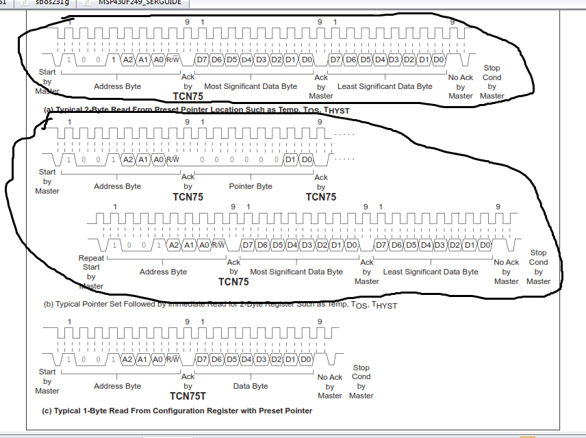

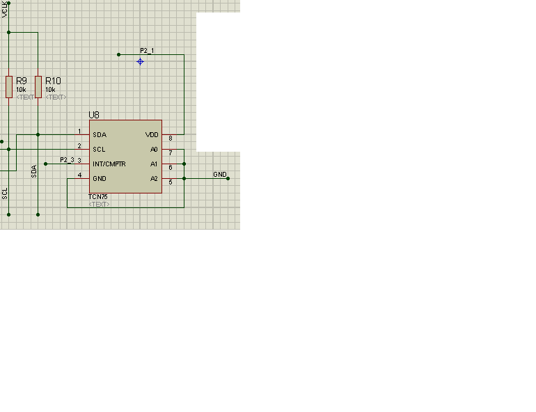

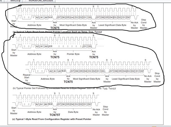

  • I used this code for interfacing with TCN75 temperature,but the result Rxword = 0.
    here is sequence of communication of TCN75
    TNC75 or TMP100?
    It you already use the code, you should know what it does and what it does not.
    Also, just receiving two bytes is a valid operation, according to the posted timing diagram. Just not the only one.
    If you really don't know what's going on or how to do it 'right' (even though there is nothing 'wrong' (= buggy) here), you should read a bit more. And be a bit more informative and detailed (and less generic) about what you want to do, what you expect and what you get and why it isn't what you want.
