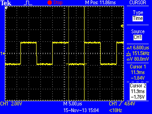

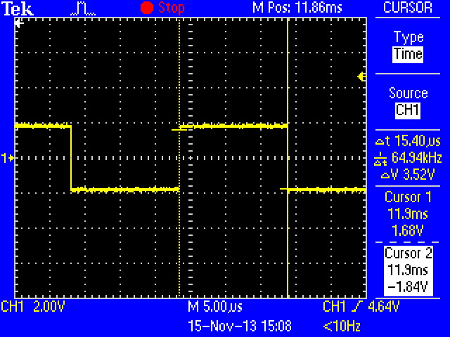

  • Dear Sir,
                       Your information was right with calculation(Number of count*1/Selected Frequency), But i made one experiment on __delay_cycle();, I had given number of count value 1, with the calculation it should give 1us delay but it is giving 6.60us delay i checked this with Oscilloscope. for information i have attached code and two images here.
    How to know the Default frequency is 1MHz with MCLK, Can we able to check the MCLK frequency with inserting any code or functions ?

  • how do you set your MCLK to 1 MHz, could you post the clock module code in here?
    Are you using an external Oscillator like a quarz, or is the internal DCO?
    Thanks for your Oscilloscope shots anyway, but if you dont know what MCLK you are working with how can you ever know how long 1 delay cycle is?
    I dont know if your MSP430 has it but some bigger MSP430 ( bigger = more pins like 80 ) have a MCLK pin, on which the actual MCLK clock can be measured, so perhaps yours has one too.

    You can't measure exact delay_cycles time using such approach because for(;;) cycle handling and also port I/O consume CPU cycles so definitely results will be more than 1us high or low time. Also you don't use DCO calibration constants, most probably your clock is not 1MHz but somewhere in 800..1000 kHz range.
    The scope shows the total execution time for the loop.
    It includes 1 MCLK cycle for the delay, but also 4 MCLK cycles for the pin toggle and 2 cycles for the jump to the loop start. 7 cycles in total.
    Test it without any delay, you'll get ~5.7µs then :)
    You MCLK frequency is apparently  1.05MHz. Which is pretty much the average default speed on 2x family.
