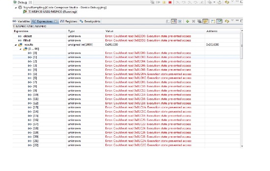

  • I tried the following code on a MSP430F5419A. It seems to work.
    #include <msp430.h>
    #define Mclk 1048576u /* default frequency */
    #define Size 100 /* size of result buffer */
    __no_init volatile unsigned results[Size];
    volatile int oldest = 0;
    volatile int filled = 0;
    void main( void )
      WDTCTL = WDTPW + WDTHOLD;
    // Set up 5 port pins to show activities and clocks with a scope
    //     --- They do not help nor hurt the program execution
    // P1.1 (pin-18) => TA0CC0 OUT, leading edge starts ADC12 conversion
    // P1.7 (pin-24) => New result arrived and processed
    // P1.0 (pin-17) => ACLK = 32.8 kHz
    // P1.6 (pin-23) => SMCLK = 1.048 MHz
    // P2.0 (pin-25) => MCLK = 1.048 MHz

    1)Using the line "[oldest++] = ADC12MEM0;"  it is showing "error:unable to read" for ADC12 in the register list.
    2)Not using (Commenting) this "[oldest++] = ADC12MEM0;" its running and is displaying a continuous alphabet a on the terminal window.
    Don't know why the line  "[oldest++] = ADC12MEM0;" is making the ADC unreadable.

    If you run the code I sent you without any change and stop it after 2 seconds or longer. Can you display the values of the variables oldest, filled, and results[0...999]? What are their values?
    Which debugger are you using? After your change, what baudrate are you using for the UART? Did you get aaaaaaaaaa...?
    You said the line "[oldest++] = ADC12MEM0;" Is it actually "results[oldest++] = ADC12MEM0;"?
    -- OCY

  • I do not use CCS (I think it stinks). But in this case, I have to give it some credits. It is telling some almost readable explanation. It says “Error; Could not read 0x023D0; Execution state prevented access” etc. I took that to mean “I cannot run and chew gum at the same time”.
    I anticipated that most debuggers couldn’t do both at the same time. That is why I told you to start to run the code, stop it after a few seconds, and then display the variables after it is stopped. I did not anticipate that it tries to display the variable while running and complains that it could not do that. (I am glad that it did not swallow the gum.)
    Is it possible to start to run the code -- without displaying the variable, without single-stepping, without any break-point, without trying to do anything else at the same time?
    Is it possible to stop running after a few seconds?
    Is it possible to display the variablea after it is already stopped?
    Please give it another try. If that still does not work, I will try to write the code to send the result to a Hyperterminal. Is it possible to use 19200 b/s or higher speed?
