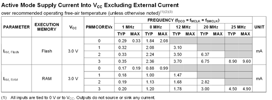

-MSP430F5419A datasheet(http://www.ti.com/lit/ds/symlink/msp430f5419a.pdf) provides typical power consumption as 230uA/Mhz and on page 42 it shows max value as 960uA/Mhz @ 25Mhz

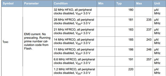

-EFM32G222 (http://www.silabs.com/Support%20Documents/TechnicalDocs/EFM32G222.pdf) which has ARM cortex M3, shows power consumption as 180µA/ MHz and on page 10 it shows current consumption as 235µA/ MHz @ 28Mhz

  • thanks for the link. I donno why many people say that  MSP's are the lowest power is it due to voltage(MSP=3.6max and ARM=3.8max)
    In both the data sheets on page 42 in MSP and page 10 in ARM the current consumption values are weird.
    If we observe the MSP datasheet(pg 42) it shows current consumption increases(35 to 960 uA) from 1Mhz to 25 Mhz.
    where as in EFM32G222 datasheet(arm)(pg 10) it shows current consumption decreases(220 to 180 uA) from 1.2Mhz to 32Mhz.
    how can current consumption increase in one and decrease in other MCU when frequency increases. usually when frequency increases current consumption increases(AFAIK).
  • karthik a said:
    -MSP430F5419A provides typical power consumption as 230uA/Mhz and on page 42 it shows max value as 960uA/Mhz @ 25Mhz
    -EFM32G222 which has ARM cortex M3, shows power consumption as 180µA/ MHz and on page 10 it shows current consumption as 235µA/ MHz @ 28Mhz

    "where as in EFM32G222 datasheet(arm)(pg 10) it shows current consumption decreases(220 to 180 uA) from 1.2Mhz to 32Mhz"
    Microcontrollers have a static power consumption, which is not related to the running frequency and a dynamic which is related to frequency. The number depends on how the calculation is done.
    STM8L has a dynamic of 220uA/Mhz and a static of 330uA, which represents 550uA @ 1Mhz and 3850@16Mhz which is 240uA/Mhz at this frequency, way lower thant the 550uA/Mhz@1Mhz.

  • "as 230uA/Mhz and on page 42 it shows max value as 960uA/Mhz @ 25Mhz "
    sorry for the mistake actually it is 9.6mA @25Mhz, so 9.6/25 is 384uA/Mhz which is still higher than ARM's 235uA/Mhz..
    Thank you for the replies
    That's maximum, not typical (or even minimum found on selected devices). And for execution from flash. Execution from ram is only half of it.
    It also includes the operating current for the clock generation with DCO and a watch crystal (which is usually excluded on the competitor's data).
    Digging deeper, the DCO apparently consumes 83µA @1MHz. (LPM0 to LPM2 difference) I guess if you clock the MSP with an external oscillator instead of the internal circuitry, you'll spare these 83µA/MHz too (maybe more on higher frequencies and not linearly increasing).
    On 8MHz, you're at 230µA/MHz too.(110µA for RAM execution). Minus DCO operating current.
