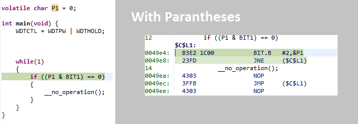

  • Hi Greg,
    Have you had a chance to look at the dis-assembly of your program?  I do not believe that there is any compiler error taking place; rather, the compiler is making an assumption on order of operations that is different than your assumption.
    The examples cases below should illustrate this.
    1. First, let's look at what happens with parentheses (this is your test case that works).  I've faked out a P1 register with a volatile byte for this example.  Everything else matches your test case.  Notice in the disassembly of the if statement that the first action taken is a bitwise AND (BIT.B) between the value BIT1 and P1.  Then, if that result is zero (JNE), the if statement is entered.  This works as you intend in your application.

    Best practice in C-code is to use paranthesis with multiple bitwise/logical operations that are inline.  The MSP430 compiler assumption here is an MSP430 assumption; there is no C specification for left-to-right or right-to-left in this case, (at least to my knowledge).  You can include the parenthesis in your #define, if you do not wish to include them every time you reference the port input.
    Walter
