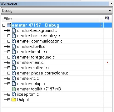

Which C file is compiled during download and loading?
I wonder what file gets loaded and compiled into Micro-controller on this IAR IDE?
I know it is not possible to compile and load two C programs at the same time. If the main will be, so what is the point to have all of them within workspace?
Can anyone explain this please?
Thank you.

  • Walter, please let me pose my question in other way. I am wondering the results that I can get from the LCD or LED on the board comes from compiling of all "C"s? Or special C? As I rebuild all the "h", "C", and "lst" or other files and then load and debug?
    Let's say if I would like to see the impact of EEprom "C" file on the functionality of Micro, what shall I do?
    BTW, I deleted the "main.c" and the program did not work!

    Each .C file contains code. Usually, code that belongs to a certain aspect of an application, like EEPROM access, LCD output, Button checking, is put into its own .C file.
    The main application code then uses the code of these separate .C files (made known to it by the .h files which describe the contents/capabilities of their associated .c files).
    Once all .c file shave been compiler separately, the linker collects all parts of them which are used by another .c file (starting from main() ) and links all together into the final application, which is then uploaded to the MSP.

    Obviously. Main is the staring point for the linker. If there is no main, nobody is using the other parts of the code and the linker won't link anything.

    The compiler compiles one C source file at a time, each by itself, into an object file. The C source file may include header files to know which functions or global variables or constants are available by other C files or libraries in the project.
    YOu add all C files, as well as all libraries you want to use to your project. When you say 'build', the compiler will compile all C files in the project, then run the linker.
    The linker will take all object files looking for one that contains the 'main' function. Then it looks which functions or globals are uses by main or other functions in the same object file, and links them to the other object files (recursively, so the object file with main may use a function in object file two which uses on in object file three etc.)  When all object files are linked, some function calls or global symbols may still not be resolved. Then the linker will go through the libraries you specified (in exact the order you specified them), and if they are found there, they are linked too (again recursively). Finally ending up with the standard library, which is always used even if you didn't specify it.
    So if you use a function X that is also defined in one of your C files, then this one is used, even if one of the libraries also contains a function X.
    Hopefully, all functions and globals used in your C code are found in one of your other C files, or in a library, and the linker will finally generate a binary file from all accumulated code, which will then be loaded into the MSP.
