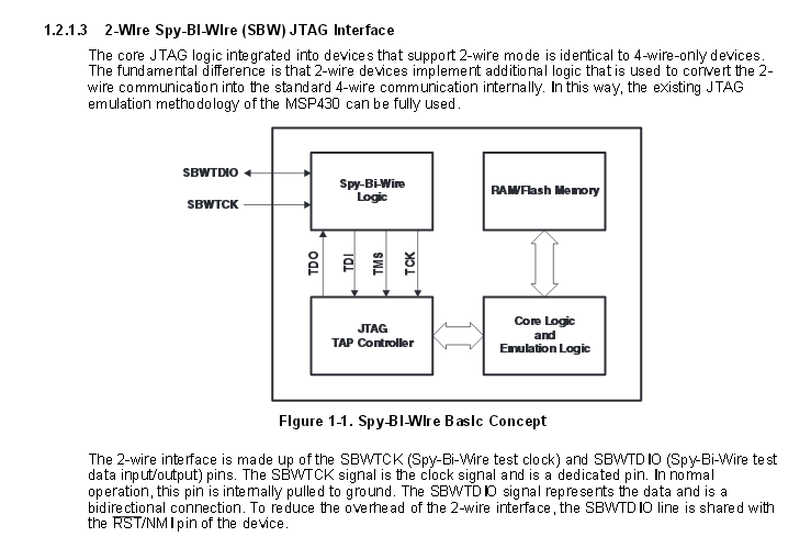

    I use the ez450-rf2500 tool ( http://www.ti.com/tool/ez430-rf2500 ) for uploading the firmware and for serial communication with the MSP board.
    If the BSL of MSP430F2274 use only the pins P1.1 and P2.2 for communiaction, how this FET can write the firmware in the MSP board?
    The pins we use for connect our MSP board to this FET are: TEST/SBWTCK (pin 1), RST/SBWTDIO (pin 7), P3.4 as TX, P3.5 as RX, Vcc and Gnd.
    The ez430-rf2500 FET use only these pins and write/read the MSP user program memory (32Kb starting 0x8000).
    How to explain this?
    Thanks in advance.
  • The ez430-rf2500 is not designed to use BSL. Hence P1.1 and P2.2 are not connected according to BSL usage. But lucky for you, they are not connected to other things either. Thus if you want to use BSL, you only need to add two wires so that they are in parallel with P3.4 and P3.5. When you use BSL, P3.4 and P3.5 are inactive and will not interfere with BSL. During other operations, P1.1 and P2.2 are inactive (by default) and should not interfere with other operations either.

  • Sandro Souza said:
    But, if ez430-rf2500 is not designed to use BSL, how it can to write and read the firmware (user program memory) of MSP?
    May you tell me/us what this FET does?
    How it use these pins I'd said before to write a new firmware?
    Thanks in advance.
    Most likely using Spy Bi Wire.
    http://www.ti.com/lit/ug/slau320l/slau320l.pdf
