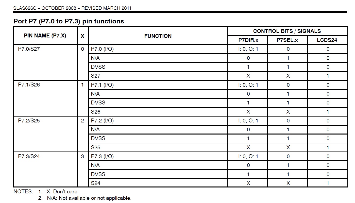

p7.0 of MSP430F47197 is connected to one of my LCD's leg that needs to be high to clear the LCD. According to the following page(74) of the datasheet, if I am not mistaken if p7.0 wants to be high as OUTPUT p7DIR must be 1 and P7SEL and LCDS24 must be low (0), right?
But I have no clue if I can choose P7 bits one by one? If I write in C and let's say P7.0 sets to 1 IAR gives me a warning.
How can I set a single bit of Port 7 or other ports to low or high?
