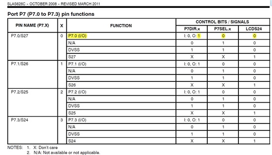

The thing is I am using MSP430F47197  and would like to connect it to the LCD.
The issue is even though I know my connection of LCD to the board (hardware-wise), I do not know if the ports are communicating with micro or not?
On the pages 74 and 75, it is said "Function" but I don't know whether I need to use P(O/I) or S which is a pin number.
Let's say E is assigned to the pin P8.2 but this pin has DIR, SEL, LCD Control.
That is why I am a little bit confused. Do you have any experience on this?
The question is how to address the MCU's pins in order to communicate with LCD.
    Chip MSP430F47197 you use can drive bare LCD directly which is not your case because display you use already have built-in LCD controller chip which shall be controlled using CMOS logic signals as per datasheet.
    You mean that I do not need to initialize and define functions and just use LCD controls in MSP?
    Opposite:

    Well, actually I know that I need to set its bits (as you said logic signals) to the right modes. But have no progress to make it communicate with MCU yet.
    As my LCD DBs are connected to P7 of MCU and in the datasheet of MSP430 as you can see here:
    Function part is tricky as I don't know should I set LCD24 and P7SEL to zero and DIR to 1 and follow the first line or follow the settings for S27?!
    Set the functions in LCD is easy but connecting to MCU is confusing as I can see only LCD's cells on the screen and nothing changes!
    As I said already - you don't touch built-in LCD controller of msp430 because display of your choice have one, so do not set LCDS24 bits. P1SEL is about peripheral functions which you also don't need in your application, leave them set to 0. So P1DIR register is only you shall touch (set to "1")  if your signal goes in direction from msp430 to LCD (having embedded controller). Otherwise set it to 0.
  • Ok llmars but I did not understand the link between LCD and P1DIR as my connection has nothing to do with P1?!
    This is good that you noticed my typing error.
  • Oh Ok then P7 and P8 DIR should be set to high as outputs. Right? From there on, I guess I need to define the functions and use in my main. but still need to set  LCDAPCTL0 and LCDACTL. Is this right?
    No. Because:
  • Oh I see. I will keep you updated about my findings shortly.  Thanks a lot!
