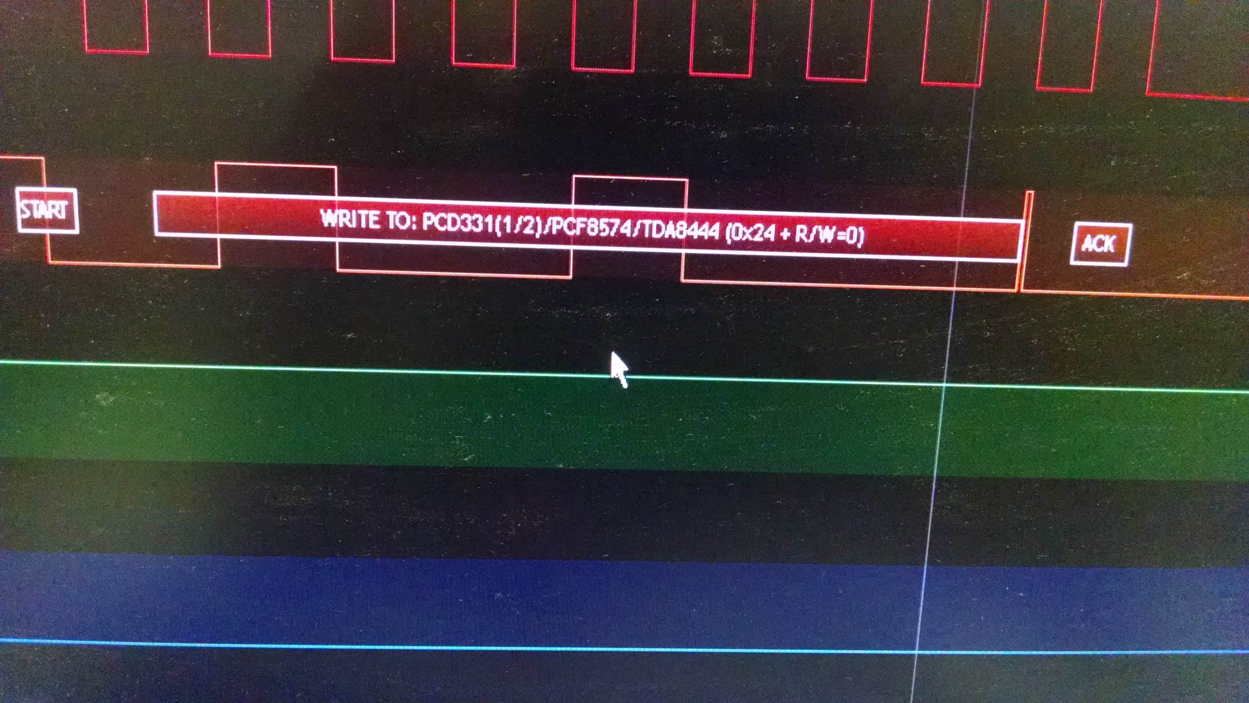

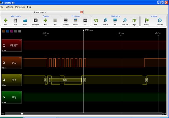

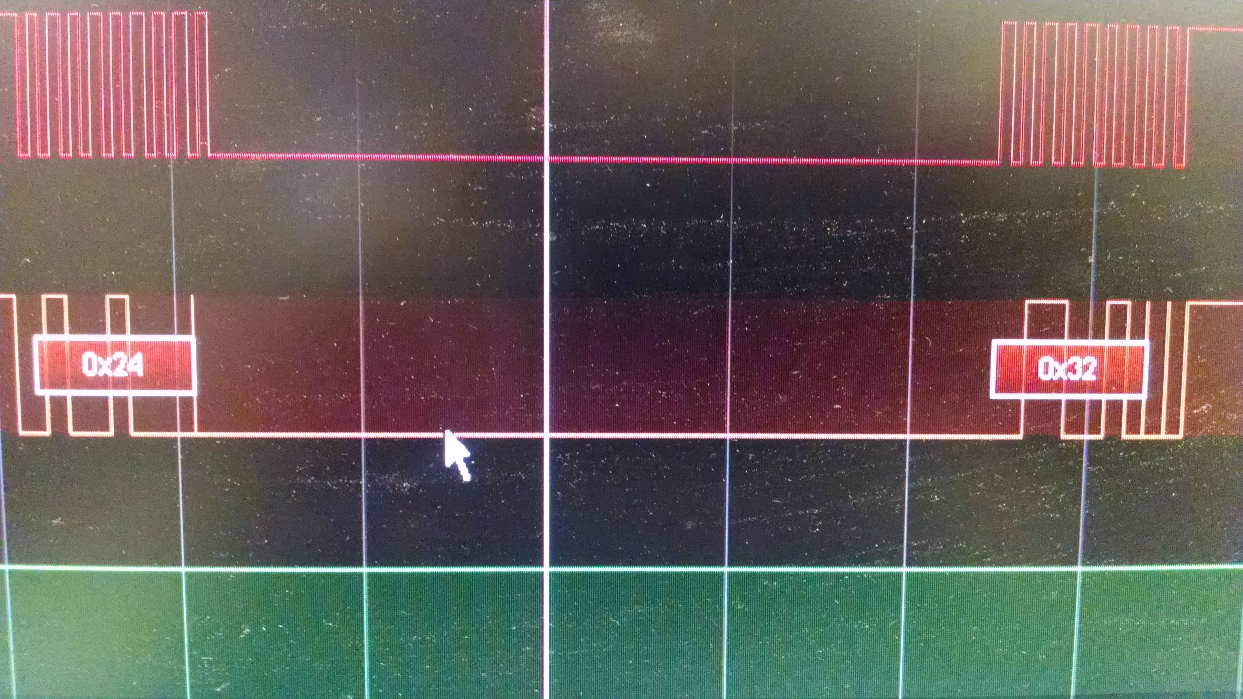

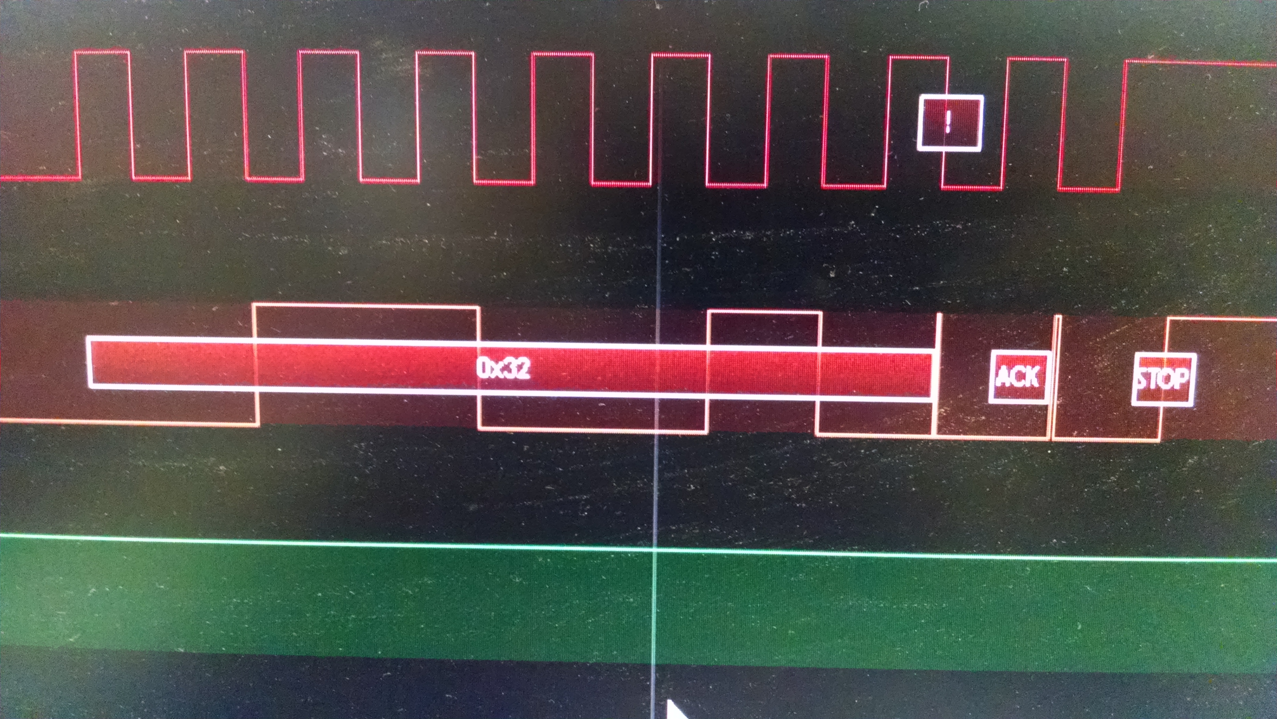

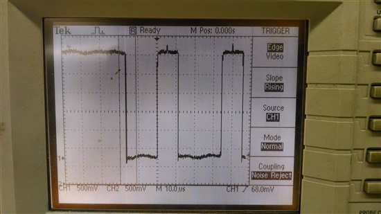

    these o'scope captures where from when it sent the slaves address successfully and did not get a ack back.
    this is the closest thing to working however its only got this far a couple of times.

    above is the SDA line it seems to do this constantly now even while the tx buffer is being loaded with what i want as i step through the code and check the registers.
    above is the SCL which it does not stop running the clk constantly.
      The code i posted is the same except with your suggested change and the port mapping change where i changed PMAPPWD to PMAPKEYID after finding it in the user guide this seemed more correct.
    any ideas?
  • It looks like there is a clock on SCL, but SDA is open circuit (not even pulled up) and catches crosstalk from SCL. The signal has only 50700mV hysteresis, which is definitely no properly driven output signal.
    At the end of your main, no_operation() doesn't wait for anything. it just wastes one single CPU cycle and then continues. Into the void, as there is no OS, main could return to (depending on the compiler-specific startup code, the MSP might enter LPM4 or reset or enter a while(1) loop or whatever, it is not defined.
    One thing I noticed when looking at the datasheet: while the pin assignment of P2 does not list any default mappings, it does have one. By default, the UCB0 I2C signals are on P2.1 (SDA) and P2.2 (SCL). You need to assign PM_NONE to P2MAP2 or you'll have a secondary output (and worse, input) to SCL on P2.2. Which will confuse the USCI logic (the USCI won't see the clock pulses it generates in the feedback)
  • Ok sure getting somewhere...
    ill post the current code and some captures right now i have descovered a new issue where the SDA line goes low sometimes after i run it and stays low dispite the pull up resistor and to fix this just long enough to run code iv just shorted it with the scl real fast it would then go high and i could run my code.  I tryed also setting the internal pull up resistors but it did not help.
    anyway  now when i run the code with your suggestion as well as the fix in the port maping i get logic levels on the oscope and a clock. when i ran the capture it got the slave adress pluse r/w bite then a 0x32 (which shouldnt be in there at all) both got an ack back then a the stop condition oh and i did get the start condition.

    that is the code as of right now
    any ideas? and the tx buffer when i step through the code for the first time is not putting my whole array in but that 0x32
