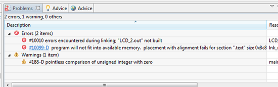

i am using MSP430G2231 and i am making an ohm meter and hence want to display resistance values on LCD(4-bit mode). I want to check its value and then display it on LCD but using numerous comparisons and float variables has made my program to exceed the 2KB flash of the MCU.
The Error while compiling is:
the part of the code which i am using to check the range of Resistance and displaying on LCD is:

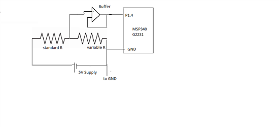

    Before we even consider to optimize very ineffective coding of range() - please tell how do you measure Ohms and MegaOhms using 10-bit ADC?

    and about measuring resistance then i am measuring voltage across the resistance using 10-bit ADC and the using voltage divider i am calculating the resistance
    the circuit diagram is:
    then i have to display the resistance calculated[depending upon the range(from Ohms to MOhms) of it]
    This is it? 10-bit ADC can give measurements in 0...1023 range. If you measure resistance up-to 10 MOhm then single count of ADC, meaning accuracy of measurement in this case is +/- 10000000/1023 = 9775.2 Ohms. How do you plan to measure Ohms with planned display range 0...9.999 meaning +/- 0.01 Ohm accuracy in case of 10-bit ADC?
    llmars,
    i am using internal reference of MSP430 of 2.5V to measure the voltage across the resistance.
    Eg; voltage applied = 5.03V
    standard R = 100k
    Variable R=47k(46480 ohms)
    then using ADC i am measuring voltage across 47k(variable)
    V=1.572581 V (should be 1.582V according to multimeter reading) error = +/- 0.59%
    then using this voltage i measure the corresponding R value using voltage divider
    R(variable)=(V / applied voltage-V) * 100k(standard R) = 45484.2471 ohms
    this is giving accuracy of +/- 2%(approx)
    and i have to display this value on LCD like 4.548 (x10k) Ohms
    please suggest if there is a better way to display the Resistance readings
    Udit
  • Udit Khanna said:
    standard R = 100k
    What standard R will be used for other measurement ranges? For 10Ohms and for 10MOhms?
  • Ilmars said:
    standard R = 100k
    [/quote]
    Standard range of R
    100 0 to 100
    1000 100 to 1k
    10000 1k to 10k
    100000 10 k to 100k
    1000000 100k to 1 M
  • Good. Then CPU anyway shall know which exactly of "standard" resistors are connected, so you can use this information in your code, in result display function knowing R_standard identifier (0...4) and ADC measurement (integer in range 0...1023) can display result. No floating point variables or math needed, only your brain - to think how to do it using integer variables and fixed point math :)

    for(m=9;m<=0;m++)
    The end condition in this loop is nonsense, since m is an unsigned int and therefore cannot be <0. Also, m starts with 9, which is >0 and therefore the loop immediately ends, as if it were "i=9;while(0){...}".
    The compiler gives a warning here.
