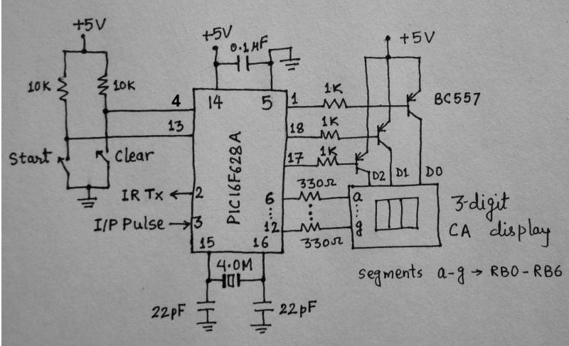

Here used 3 digit common anode 7 segment , 10 pins display. But i have a 3 digit common cathode 7 segment display (HX04301BHB), can i use it by inverting the input of 3 digit 7 segment display by using (74LS04) ic, may it work here?
You need to use NPN transistors (instead of PNP transistors) and connect the emitters to GND (instead of +5V).
You do not need to invert the control signals with hardware such as 74S04. Your firmware can do the inversions.

8 segments for each led, the 3 digits all shares the high-side connection.
You have 3 low side connection, that is the common cathode for each digit.
C is after A, Ground is after Voltage is easy to remember.
So you would now have to multiplex this, the msp430 pin drive is a little weak but if you use 600ohm
resistor to 8 mcu pins it probably will be OK and directly drive the 8 hi-side lines.
Now you need 3 more mcu pins that drives 3 npn mosfets for the low-side,
Only 1 our of the 3 should ever be on at any time.
Now go through each digit about 200 a second and there should be no flicker.

I have 3 digit common cathode 7 segment display (HX04301BHB) , 10 pins
i want to use this replace of 3 digit common anode 7 segment below in this pic.
7 segment display has 10 pins input which pin is D0,D1,D2 and a,b,c,d,e,f,g of the " 3 digit common cathode 7 segment display (HX04301BHB)" , 10 pins ?
Simple, replace the P transistors with N transistors/mosfets
And connect those N-Channel-source-pins to Ground. (e.g a low-side switch)
My guess is PIN 8,9 and 12 is each digits Common Cathode (its ground)
Use 3v and a 330ohm resistor and poke around and you should be to figure it out,
as a LED=Diode and will only lit up if connected correctly.
