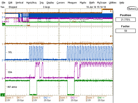

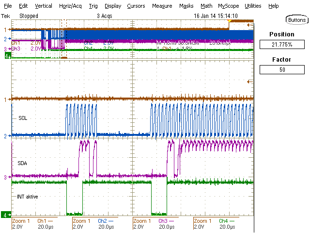

I think, I run into the I2C-Erratum USCI30. But the Workaround doesn't work.
I use Master Repeated Receive with UCB0.
The Symptoms are  ( s Picture):
  • SCL clocks endlessy
  • No Interrupt any more
The green Signal shows the duration of the Interrupt-Routine.
The delay comes from the Workaround ( waiting for SCL == LOW). The error comes during the reading of bytes.
Do you have any hint?
I've appended the ISR.

  • Hi Steffen,
    I have a couple of questions for you:
    1. What device are you using?
    2. What is the I2C clock rate?
    3. What are your I2C pullup resistor values?
    4. How long are your I2C traces?
    5. How many I2C devices are connected to the bus (including the master)?
    From what I can see of the scope shot, it looks like your I2C lines may not have a strong enough pullup for the bus speed you are running.  The shot is zoomed out enough to make it difficult to tell for sure, but that might be an issue.  If the waveforms are not square enough, the 430 (or other devices on the bus) might be missing some bits and lose sync with the I2C transmitter.
    Another potential issue is your USCI30 workaround.  From quickly looking at your code, I don't think you have implemented it correctly.  The errata document doesn't do a great job of explaining the workaround, but you need to monitor the UCSCLLOW bit continuously (or nearly so) to ensure it stays continuously low for >3x bitclock cycles.  This guarantees you have stalled the bus and it is safe to read the RXBUF.
    Looking at your code, I think you are checking UCSCLLOW a 2x the rate of the bit clock, which means you are checking twice every bit clock cycle.  Depending on the timing of this read, it is possible to catch a sequence where the sampling occurs while SCL is low, then during the delay before the next UCSCLLOW check, SCL goes high and then low again, but your check misses it and assumes SCL was low the entire time.  I typically recommend checking at 3x the bit clock frequency or even more often to ensure you don't run into the scenario.
    When the USCI30 erratum workaround is correctly implemented, you will see the MSP430 stall the I2C bus after the 7th bit of every byte except the first byte received.
    Mike
  • Hi Mike,
    thanks for your quick reply.
    1. What device are you using? MSP430F5528
    2. What is the I2C clock rate?  380kHz
    3. What are your I2C pullup resistor values? 10k
    4. How long are your I2C traces? 5cm
    5. How many I2C devices are connected to the bus (including the master)? 1M+1S
    I will try an loop  only with UCSSTAT test. How many loops do you suggest?
    Is there a testcase to verify the fix? I have to wait for minutes until the bug appears.
    regards,
    Steffen
  • Steffen,
    10K is definitely too weak of a pullup value for I2C at 400k (or close to it).  I typically recommend 2.2K to 3.3K for 1M + 1S  with relatively short traces at ~400K.  5cm is a little bit longer, so try maybe 2.2K and see if that helps.

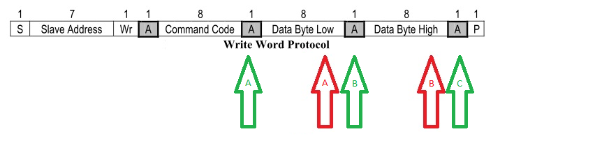

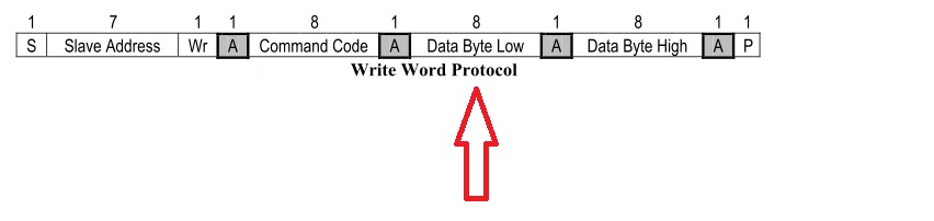

  • Thanks Mike,
    summarizing:
    CASE i2C SLAVE @  100KHz - Protocol SMBUS - Write Word
    Below there's a picture of the SMBUS protocol mentioned.
    The red arrow indicates the ONLY byte in the protocol where to apply the USCI30 workaround, right?
    In the following code I've added a signal (CHECK_SIGNAL) to indicate the time where the patch is working

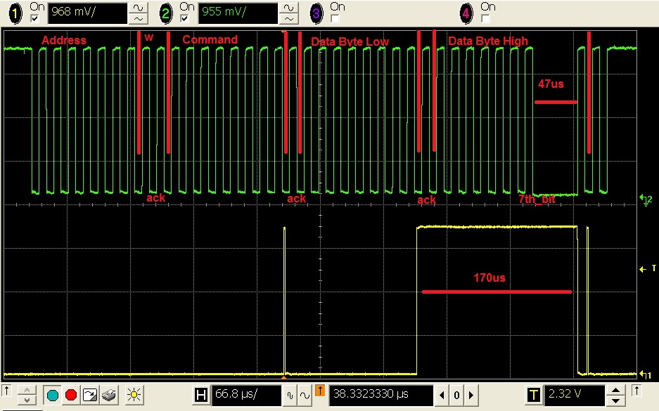

    Using this code, I obtain the following waveform (green signal-> SMBUS_CLOCK; yellow signal->CHECK_SIGNAL)
  • Post the correct code because the page formatting is gone
    No, the workaround should be applied to both the command byte and the data byte low.
    In I2C on the MSP430 USCI module, the RX flag is set once the entire byte has been received.  See the green arrows below, where A is the command byte RXIFG, B is the data byte low RXIFG, and C is the data byte high RXIFG.
    Since USCI30 applies to every byte except the last one, it needs to be applied to the ISRs for A and B, but not C.  When applied correctly, the USCI30 workaround will NOT read the data out of the RXBUF and wait for the bus to stall after bit 7 on the next byte.  Once this stall last for >3x bit clock cycles, the workaround should read the byte out of the RXBUF, which allows the bus to resume sending the 8th bit.  The net effect of this is the ISR that is generated at green arrow A (for the command byte) should stay in the loop waiting for SCL to be low for the required amount of time, eventually causing a bus stall at red arrow A.  After the 430 observes SCL held low for a sufficient period of time, the RXBUF should be read (the command byte), which releases the bus stall and I2C communication resumes.  The exact same thing should happen with the RXIFG at green arrow B, causing a bus stall to be observed at red arrow B.
    However, since the RXIFG at green arrow C is the last byte of the packet, the USCI30 workaround should NOT be applied, and should be read immediately.
    Mike
  • Code modified:
    #pragma vector=USCIAB0TX_VECTOR
    __interrupt void I2C_TransmitReceive_ISR(void)
            if ((IFG2 & UCB0RXIFG)!= 0)
                usci30_workaround_counter = 0;
                // USCI30 workaround applied ONLY on DATA_byte_Low
                CHECK_SIGNAL_HIGH
                while ( usci30_workaround_counter < 9 && (data==Command || data==DATA_Byte_Low) )
                    if ( UCB0STAT & UCSCLLOW )
                        usci30_workaround_counter++;
                    else
                    sleep_us(3); //3usec sleep
                CHECK_SIGNAL_LOW
               date = UCB0RXBUF;
               if ((IFG2 & UCB0TXIFG) != 0) { ... UCB0TXBUF = tx_date; ... }
    And below the waveform:
    What bout the read word protocol ? There's a command byte also there.
    and the relative waveform:
    But while the write is now ok, the read is still doing errors.
  • wrong picture about smbus read word-> the correct is below
  • On the SMBus Read, the USCI30 workaround does not need to be applied to the command code, as long as the command code is only one byte.  This is an I2C packet that is only a single byte long, so there is no need to apply the workaround as the only byte is also the last byte of the packet.
    Your waveform the the SMBus write looks like the USCI30 workaround is functioning correctly.
    Mike
