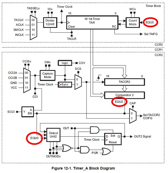

EQUn: What is it an Acronym for?
In the Timer A block diagrams, there is an internal EQUn signal, where the letter 'n' denotes the block context.
  1. Is it an acronym?
  2. What does it stand for?
  • EQUn is acronym for "comparator equal" logical signals of timer block. You can see that EQU2 comes out of CCR2  register "box". CCR0 and it's EQU0 is special - that's why it is connected to multiple places
