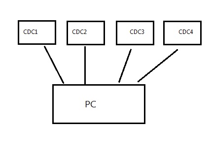

  • I took TI's CDC_Example from Developer's Package and used all the code structure, I only changed the code within the case: "ST_ENUM_ACTIVE", where the program goes when USB is successfully connected. After that I generated my own descriptor files (descriptors.c, descriptors.h, UsbIsr.c and the MSP430.inf) and made a rebuild. The layout of the project is as it follows:
    There are four boards. They should work as individual Virtual Coms, testing a device and sending information to the host (PC). The PC gets the incoming data from the four boards at different COMS and process them.
    I'm getting a problem when connecting all the boards at the same time and running the Software at the PC to get the data, I don't know if this is really what's happening, but it seems they start loosing connection when the process begins.
  • OK, I think I understand your setup better.
    • Four individual boards
    • each with a single CDC interface
    • each with its own VID/PID pair (same VID, different PID).
    • Each seems to work (meaning, bidirectional communication; using a terminal app on the PC?) when it's the only board attached.
    • But when all four boards are tried simultaneously, it fails.
    • Failure seems to involve some kind of instability.
    • The instability is something like "when the boards try to send something to the PC, the device manager refreshes, like if some connection was suddenly restarted"
