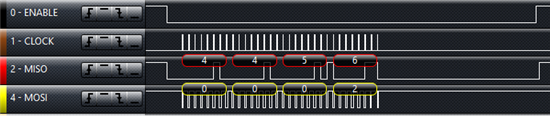

    I noticed it after post the thread. My real problem now is with the code at the end of this post (the slave code), I get the following signal.
    My question is, why the MISO line keeps in high level after the communication, is all correct?
    If I use cnt=UCB2TXBUF instead cnt++ the output has no sense. Why it occurs? It should be the same that the entry, right?
    Because the last bit was a '1'. If the last bit had been a '0' then the MISO line would be low after the transfer. The MISO is driven by the output of the shift register, and after the last clock edge it stops shifting, so last bit stays on the output. In fact, it must be this way, because the slave has no idea when the master is going to sample that bit. It could be anytime between the positive clock edge and the next positive clock edge. (Typically it happens at the negative clock edge, but that's not a hard rule)
    I guess that depends on what the MSP430 does to the TXBUF register when it reads it. What do you expect to see and what do you actually see? I think I would expect the MSP430 implementation to be what was last written there since it doesn't have a FIFO mode.

    Sorry I want to say cnt=UCB2RXBUF. If I use cnt= UCB2RXBUF, the SOMI line must be the previous byte sent by the Master but it isn't and has no sense.
    my other problem is while I am sending a array (in this case and array of 4 bytes) the first two bytes are repeated and in the first array the first byte must be "0x01" but it is 0x00.
    This is the first array, as you can see the first byte must be "1" but it's double zero.
    The second arrive must be start with "3" due to the first arrray finished with "2" but it's double four.
    Why it occurs?
    A last question if I use the line while (!(UCB2IFG&UCTXIFG)); in the case 2 of the interrupt it freeze the device after the first array. Why?
