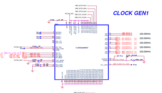

I am using the MSP430F5438A uC to configure the CDCE62005 on my board.
When I power up  the board the CDCE62005 device loads with the factory defaults and I can measure the clock outputs (e.g output 4 is 125 MHz LVCMOS).
When I try to send a configuration data to any of the device output registers (0-4) the output signal is terminated.
I monitored the SPI bus and it seems like I'm sending the correct data, clock and LE signals (~1MHz clock).
To test the interface I sent only the default values without changing them, just to check if I can configure the device properly to its default values.
My next test was to read the data from one of the registers to see if the data was written properly.
I sent a read command from register 0 and looked at the SPI bus data. The data was correct except for 3 leading zeros before the correct data arrived (don't know if its just 3 extra clock cycles before the valid data arrives).
I tried to read the data from the SPI RX buffer but didn't get the expected values.
What is wrong with my method?
Please see my code below:

Also see the relevant part of the schematics:

  • SPI is a quite simple protocol. And some of the low-level and all of the high-level protocol stuff depends on the master knowing the slave's requirements and limitations.
    For example:
    ronengl said:
    P3DIR |= 0x80; // p3.7 -> SPI LE
    P3OUT |= 0x80; //Set LE high
    This will generate a short low spike on the pin. It may bring the slave in an indeterminate state. Swap the commands, and the pin will go from high impedance directly to high-driven, without a short low spike.
    Other things to consider are phase and polarity of the clock signal. Note that TI clock polarity is inverted to Motorola polarity notation. So don't just copy bits, check their meaning.
    Be sure all por tpins ar einitialized properly before you select the slave. Be sure you don't de-select the slave before the data is sent. And don't forget that the answer to a command is received when the byte after the command has been sent. Probably a dummy byte needs to be sent then.
    SPI is a simple protocol, but that doesn't mean it is easy to handle.
