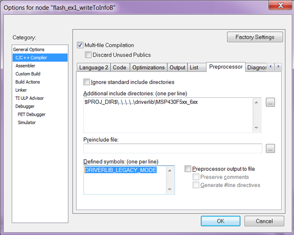

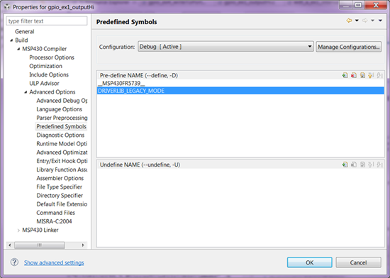

 To use DriverLib in backward compatibility mode -
  1. We provide a compiler define DRIVERLIB_LEGACY_MODE. If this is predefined in the compiler settings, the older APIs will still work as-is(Pre 1.70 Release).
  2. The user must also include  the “#include “driverlib.h” header file released in 1.60 driverlib onwards instead of the individual header files.
 If DRIVERLIB_LEGACY_MODE compiler define is absent, then the newer APIs take effect (Post 1.70 Release).

Without making the above change, most existing projects that rely on driverlib will fail to compile. Adding the compiler define DRIVERLIB_LEGACY_MODE and including “driverlib.h” instead of individual header files is necessary to get the projects to compile in legacy mode(using the older APIs). We would like to roll out an announcement in E2E so that customers can get a heads-up regarding this change before the driverlib release.

a)CCS
 b)IAR
