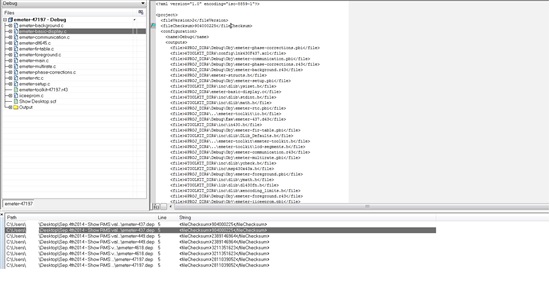

  • old_cow_yellow said:
    Some of the compiler/linker will generate CRC (or other checksum) and include that in the Flash image. Some of the MSP430 chips have CRC module.
    Also Flash Marginal Read option can detect Flash defects before they show up in normal Read.
    OCY! Where can I check this in my IAR IDE? I have the followings when I look for the word "checksum"!
    Also CRC I guess it is said only for TX-RX serial communications!

  • CaEngineer said:
    OCY! ... Have you yourself worked with Checksum option before?
    Yes, the linker moved all the code and constant to slightly higher address to make room for the check-sum, filled all the unused FLASH, calculated the check-sum and stored it at the low-address. The check-sum covered all the FLASH except itself.
