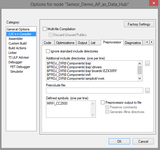

I am trying to understand the wireless sensor demo for the ez430 rf2500. I have added all the components and specified that I am using the CC2500 here:
I also added:
-f"$PROJ_DIR$\Configuration\smpl_config_AP.dat"
-f"$PROJ_DIR$\Configuration\smpl_config_ED.dat"
-f"$PROJ_DIR$\Configuration\smpl_nwk_config.dat"
to my extra options for proper configuration and unchecked the static overlay map option in the linker category. I have narrowed down the errors to just these two:
