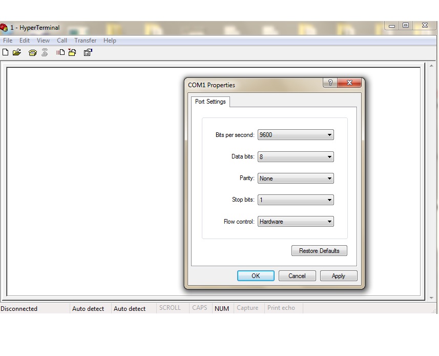

I would like to talk to the display via RS232. In other words Hyperterminal software let me type something on the its screen at the PC and sends the characters through the RS232 protocol to the MSP430f47197 and the micro show them on the display. (and of course the opposite way from the micro to the Hyperterminal as well)
Serial port is TX and RX are connected to the P1.6 and P1.7 of the MSP430f47197 as follows.
Therefore, I need to have the following code.
P1SEL |= 0x20+0x40; // enable the TX and RX
According to the link that I have found through the net as follows, I guess I need to use USART0 TXD/RXD controller. But I am not sure if I am on the right track or not for the serial communication.
http://www.referencedesigner.com/tutorials/msp430/msp430_30.php
Then I should have something like the following just to send from Hyper-terminal to the LCD.

    I followed your instruction and ended up with the following. Can you please take a look at that.

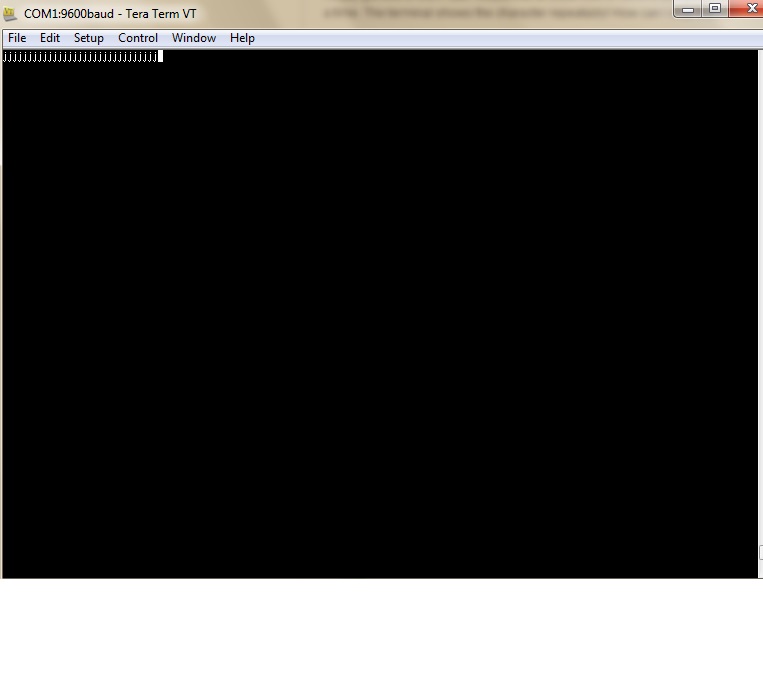

    What if I don't use interrupt and would like to send a message by Hyper-Terminal and show it on the display by having while and if as follows?

    Not using interrupts makes things more difficult but not impossible. Your main code then needs to implement sort of a state machine. It runs in a loop and only does s mall chunk of work at a time, noting in a variable which part was done and what has to be done next. Then in returns to the main loop, checks for incoming data, stores it, checks whether an incoming command is complete and then does the next chunk of work.
    You must ensure that the time between two main loop executions is smaller than the time required for receiving a data byte (so it is only suitable for lower baudrates).
    Interrupts are much easier: You receive a byte and write it down in a buffer and set a flag that new data is here. The main code can then check for this flag every now and then and see whether incoming data is complete and action must be taken - If not, it can continue normally

  • Again tested the following code, but the Hyper Terminal does not let me transfer anything through the RS232. How is this possible to send from Hyper to the Display like the following video? I need more help please!
    https://www.youtube.com/watch?v=As6VdtigvH4
    The Hyper is set as follows.
    The code as you guys recommended me is as follows.
    It's not the Hyper Terminal for sure. It's your code. First thing you shall learn: echo characters on HyperTerminal without any LCD. When your UART code works - only then add LCD.

  • I got the echo from MSP to my Terminal on PC but the opposite does not work!
    I used while as follows.
    Any idea?

  • Finally got this to work. But I would like to know how to send a string and show it on the display instead of one character at a time. The terminal shows the character repeatably! How can I stop them?
