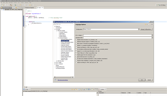

  • Hi, this is what my CCS is showing, nothing to find about floating point settings?!
    I am also using some floating point to calculate calibrated values inside a menu, so the user can set different values, there the problem also was what you described, but back then I thought this is simply due to the fact that floating point numbers you set sometimes cannot be exactly the value you set them to in the Microprocessor.
    Now what you describes sounds quite nice for me too,but as you see I couldnt find it. And another question for double usage if anyone knows,
    what I can to is coding a if-statement
    if ( float1 >= float 2 )
    can I do exactly the same with a double? does ittake like way more time to compare or use doubles in my code? I dont have quite the feeling for that usage yet, first I was also afraid that a 32 bit comparation wouldnt work in the µC, since the architecture is made for 16 bit, but apperently it does work.

  • Ok thanks for Your remarks, now still my question remains:
    1. going through illmars suggestion. I have changed the precesion of floating variables.
    Right click on projecct--> properties-->Build-->Advanced options-->language options--> Floating point precision accepted by compiler (--float_operations_allowes)  selected 64 from drop down menu.
    I could not find that point in my properties as stated above in the screenshot I posted, or perhaps I am just blind , could very probably also be.
    I am using: CCS v 5.1.1.00028
    so any suggestions will help.
    Thank You.
  • Seb, Ilmars' suggestion was about IAR and apparently, sri-sri is also using IAR. Maybe this option doesn't exist in CCS.
    According to the 4.2 compiler guide, in COFF mode, float, double and long double all use 32bit data. There is no 64bit floating point support in CCS for COFF mode. However, in EABI mode, double and long double use 64bit IEEE implementation. So precision (and size) of a float variable solely depends on the used data type.

    In which compiler mode you are in? as said by Jens Michael. R u in COFF or EABI?
  • COFF, I am using in all my projects until now, but honestly I did never care about this, because it did work jsut right from day 1 when I startet using the CodeComposer like 4 years ago.
    And as I do not have assambler background, the only thing I care about is if my code will work on my PCB, and I only start questioning my toolchain and coding once errors occur :)
    So if anyone is familiar with practical bits about the different formats I will listen carefully.
